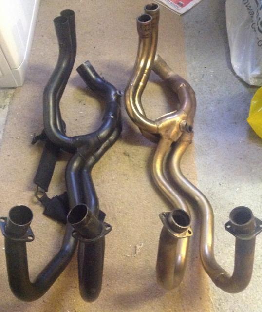

where did you weld the plug ?
Not pretty but I have seen modified sparks plugs. They take the center out and fill it with epoxy .
I see why now the cheapest one I found was at Advance Auto $14 ..
Some other forums report the wideband O2 sensor thread is 18mm x 1.5 pitch bolt.
http://www.ebay.com/itm/02-Oxygen-Sensor-Plug-Bolt-M18x1-5-Wideband-/191502426632?pt=Race_Car_Parts&hash=item2c966f2208&vxp=mtr
Zinc $4.00 free shipping !!!
http://www.ebay.com/itm/Mild-Steel-Zinc-Plated-Hex-Bolt-Bung-Plug-for-Oxygen-Sensor-Bung-M18x1-5-Thread-/281500628507?pt=Motors_Car_Truck_Parts_Accessories&hash=item418abeb61b&vxp=mtr
[image: $(KGrHqVHJBUFI3hghUVDBSOIdGQZ1!~~60_14.J]
I think he is looking for where did he drill and mount the bung for the wideband O2 sensor... I suggest something similar to Mohawks TBR header (see below on left)
i was referring more to the position of the plug on the pipes
AnikMankar
See my post just before this one...
Rush2112
isnt it suppose to be more towards the header instead of the exhaust ?
AnikMankar
Oop's
AnikMankar
Rush2112
That is only slightly farther downstream than the factory O2 sensors on the gen 5.5 & 6... that position allows measurement of all the cylinder gases instead of two or one. I understand your point about positioning and there is a "Goldilock's" distance from the cylinder exhaust port to get the most accurate reading; too close and the exhaust gases are too hot and completing combustion, too far and they are starting to cool and have consumed more available oxygen giving an apparent richer mixture than actual... you can adjust your A/F target to compensate for the position of the wide band O2 sensor if needed.
