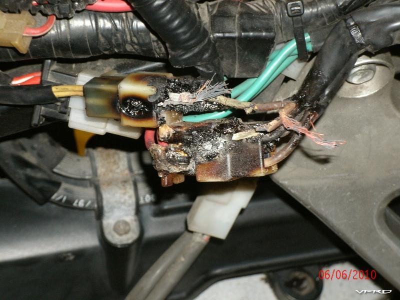

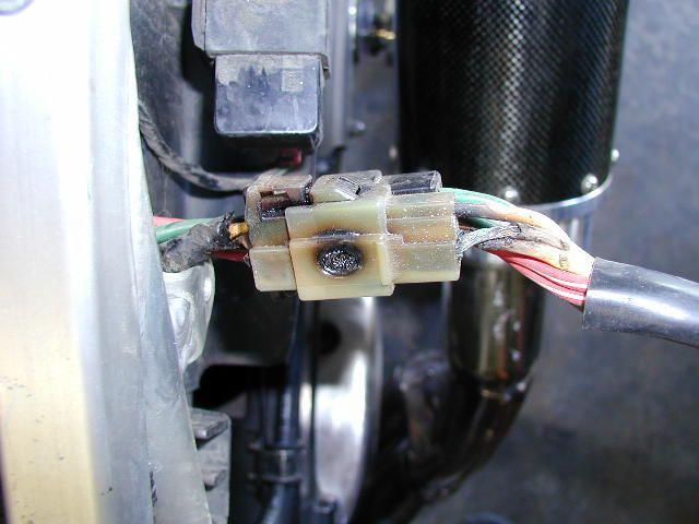

There have been numerous threads here about stator and RR and wiring harness problems. Without a doubt the 5th and 6th Gen bikes have their issues in that regard, and Tightwad has done some great work to fix those problems. And yet we still have posts about this connector melting down. This was all discussed in great detail in this post by Soichiro:
http://www.vfrdiscussion.com/forum/index.php/topic/62912-stator-rr-wires-connector-fried/page__pid__749019#entry749019
In that post were lots of pictures like this:
post-4707-0-68866500-1292556851_thumb.jp
post-4707-0-28964500-1292557024_thumb.jp
And recently we saw something about an RC45 almost burning to the ground, and BusyLittle was surprised to see his charging connector (not the RR one) getting all "melty".
post-4707-0-15203800-1292555370_thumb.jp
In that post, I stated that the reason the connector melts is the damn connector's fault, not the RR or the stator. And here's the proof:
