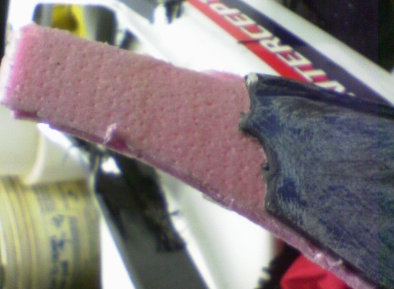

Here is the left corner of the center fairing. I taped up the outside with duct tape. then glued the pink board onto the duct tape with spray glue, The inside of the fairing has been roughened up with 36 grit paper. I have added the composite material and then painted it with epoxy. It is curing at present.
I am using carbon fiber but fiberglass would work almost as well. I have a roll of carbon so that is what I use.
