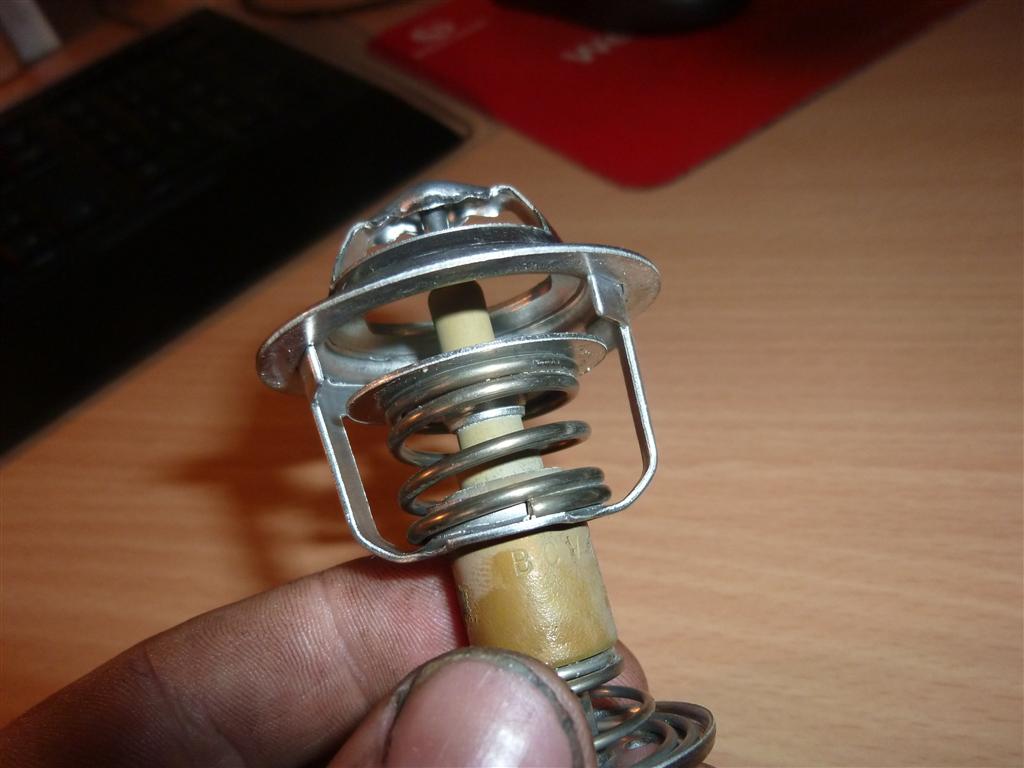

Wow, I just pulled a VERY stuck-open thermostat out of the new motor. I mean it was WIDE open; no wonder the motor was a bag of spanners on cold start - the ECT probably saw a decreasing temperature as soon as the engine was spinning and adjusted fuel mixture to "suit". Which of course was wrong and just caused the motor to stall (and stink out the garage with the smell of fuel).
Now THAT'S a stuck open thermostat
This all happened somewhere around the time I removed the old coolant. What is it with VFRs and stuck thermos?
In general though, you gotta love EFI systems which are all super-smart but can't detect things like leaking fuel pressure regulators, and stuck-open thermostats when the intake air temperature has no correlation to it. My kingdom for an OBD-II compliant ECU!

Alrighty, a cold start test has just shown that by replacing the thermostat I've cured the excessive richness at startup. Yay me!
I think the fast idle wax unit might be a bit weak though, as while it runs OK the idle is too low when cold - holding open the idle valves improves it so I do believe the problem is around that area. Maybe there's some air in the lines still. Easy enough to test and clean thankfully.
With all the troubles I've heard about RE: failed wax units, I wonder what was wrong with the lever and cable that came before??

Something else interesting though is that using my existing thermostat in the new motor the ECT reports 82 degrees C running temp rather than 76 degrees on the old motor. Only difference is I'm running only water at the moment which I'll flush out and replace with coolant once I fix the wax unit.
