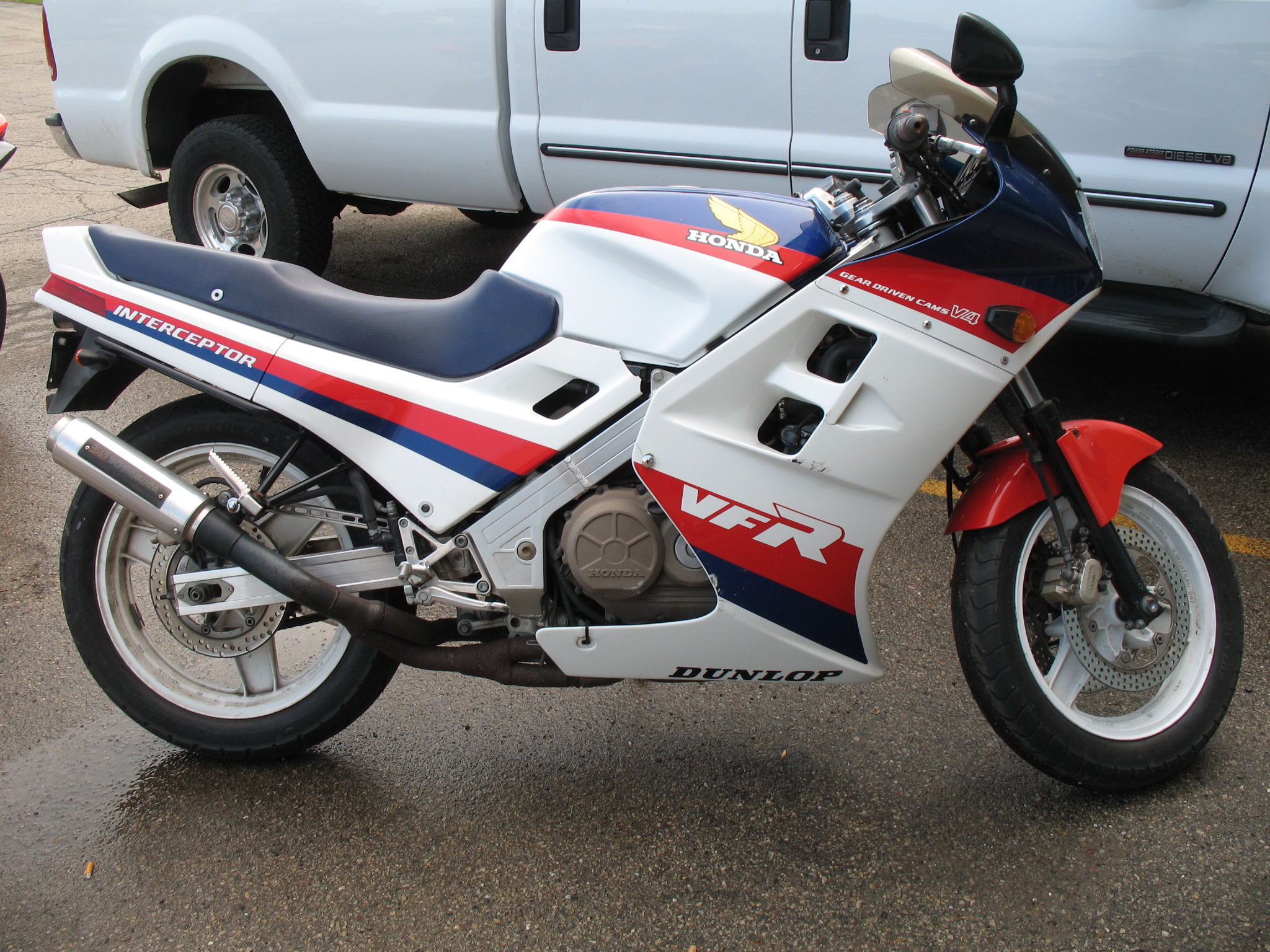

What I had done was the dual Yoshimura pipes from the collectors near the footpegs to the mufflers. They were very used, but not pitted.
I drilled out the rivits that held the mufflers to the mild steel pipes, separated them, and had the pipes dipped and stripped at the chrome shop.
I think they use a caustic or acid bath, not sure which. Then, they proceed with the nickel plating.
This isn't/wasn't my bike, and this is a 4 into 1 Yosh, I had the dual pipes, 4 into 2, but you get the idea.....
I'll see if I can drag up an old scanned pic anywhere.
