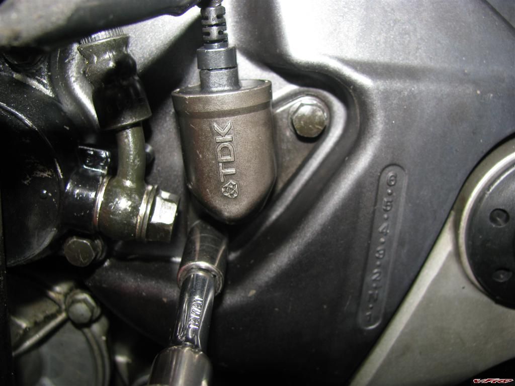

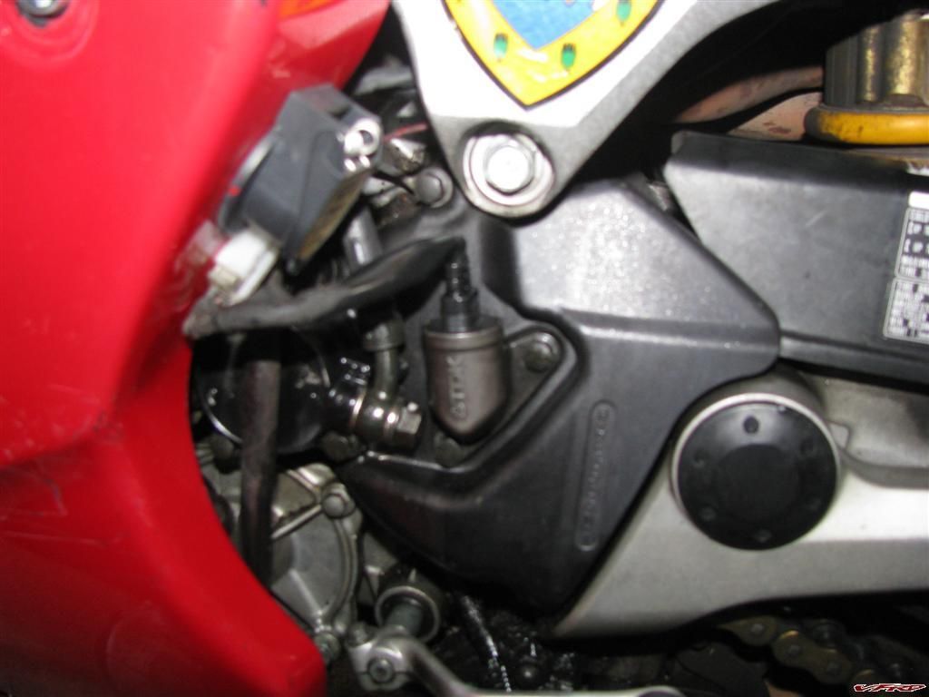

Locate the Speed Sensor it is right over the front sprocket

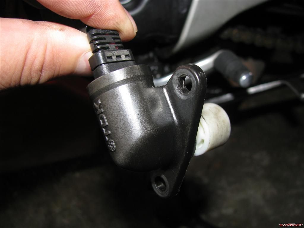

Remove the 2 bolts with an 8mm nut driver
Speed sensor pulls right out

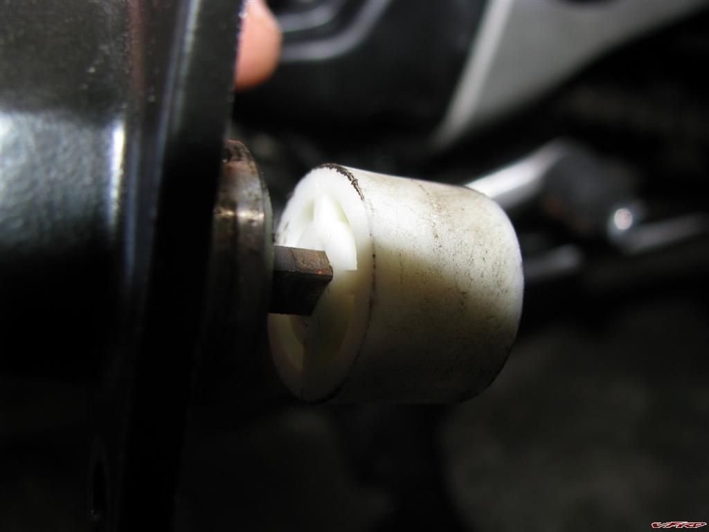

Replace the nylon nut driver the old one prys right off the shaft

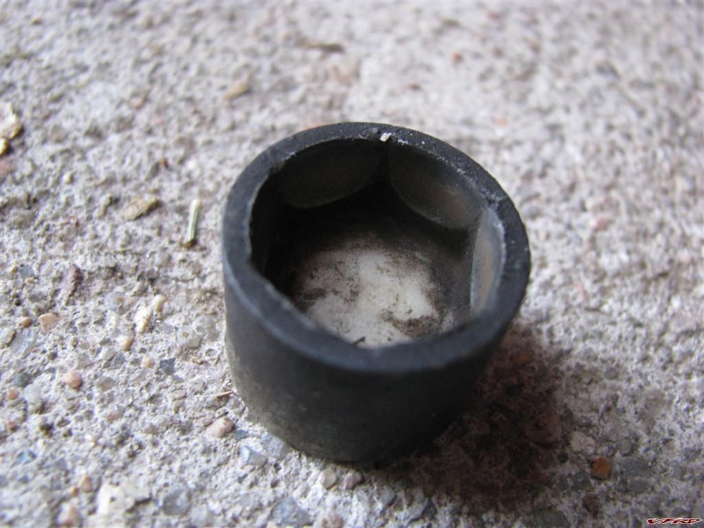

Old worn out nut driver the nylon part would not make contact with the sprocket bolt.
It is a simple 5 minute fix and the replacement nut costs around 5 bucks
