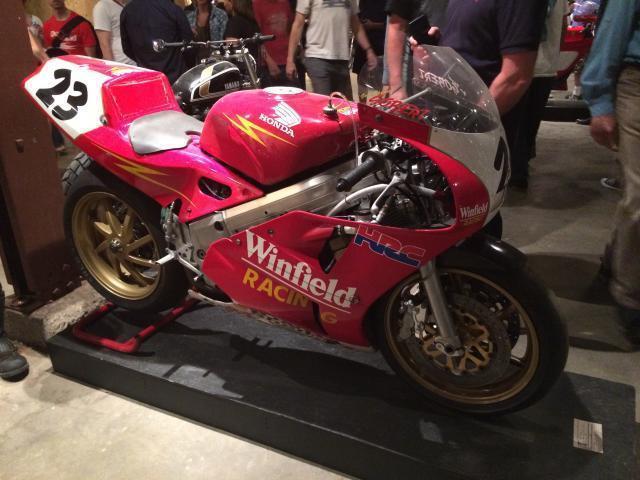

I finally got around to scanning the tintype photo taken at the Handbuilt show, printed on a sheet of steel. According to the photographer this picture will last "hundreds" of years.
[image: tintype_zps45cce7be.jpg]
Another shot from the show:
[image: HMS-2_zps2f016b13.jpg]

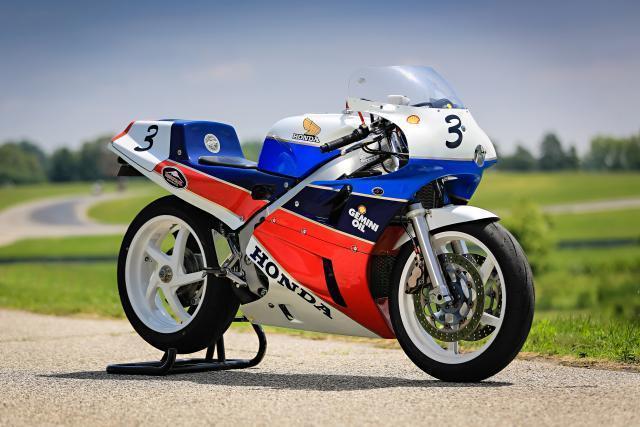

Lets see some pictures of your RC30
  This is the best picture I have of it. It was still in the previous owner's possession at this time. It's wearing track bodywork(obviously) and wheels.
Looks like it has some nice mods. Whats the history of this one?
Will you be riding it?
rc30fan
It's a Canadian, imported some years ago to the US but the importer was never able to get the title transferred(unsure of the level of effort put forth). The person I bought it from did the legwork on the title and sorted out any issues the bike had and added a few mods during the few years he owned and rode it. It has a tick over 10,000 miles now. I've had it less then a year and have been able to ride it some. One track day and a few hundred miles of twisty roads. I plan on riding it some every year. Too many people put them in their living room or garage and they never get seen by anyone. That's not why they were built and released to the public. Yours belongs in a museum because of its unique history. Run of the mill ones should be seen and heard for others to appreciate. I hope to have it for a long, long time and I also hope to put many miles on it in that time. Parts availability is always a concern but hopefully with AHRMA making them legal, some people will step in and start making consumables again. Ohlins has made a few batches of rear shocks and sold every single one they've made so there's definitely a market out there.

Anyway, I'm in Sydney visiting family and I heard a rumour about the sister bike to mine. I followed up and look what I found:
[image: IMG_4061_zpsfj5rn8gs.jpg]
This bike is identical to mine in all but a few ways.
- polished frame
- stock brake calipers
- ohlins steering damper
- endurance fuel filler
- welded-on side stand boss (required for homologated superbikes back in 1994)
- non-running. (Although it needs some serious work its nothing an experienced RC30 mechanic couldn't do)
Anyone interested can see more pictures here:
http://s841.photobucket.com/user/rc30rdr/library/Winfield%20RC30/sister%20bike?sort=3&page=1
Hi Shaun, is it the one at Western Motorcycles?
regards Murray
The Phantom
regards Murray
Thats the one. The owner, Ray, is a great guy.
Edited March 6, 2016 by rc30fan
I hope Ray was ok about wiping my drool off it :goofy:
So, did you raise the possibility of Ray making it two from two?
He's not in the market for another RC30, although he knows other people who might be and said he will let them know mine is available for sale.
