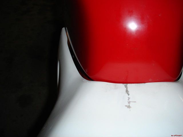

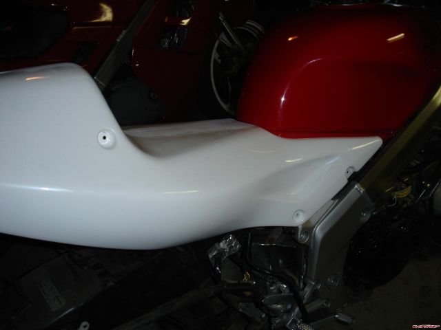

Now i've some problems with the rear fairing. It doesn't fit to original tank (more wide than rc45 tank). I've cut it and now is unusable. Do you know a rear fairing for rc45 that fits on vfr750f tank?

From what I have seen over the years, all RC45 bodywork requires adaptation to the VFR frame/tank.One of our members Mr Matt may have some ideas for you?

I think on my tail section the bodywork was actually a little wider than the tank, I think I bought mine from Airtech since it had 3 mounting points on each side instead of 2.  Thurn Motorsport in Germany has one that is a blend of the 4th gen and RC45ish style

  I think I shaved away to the second line here, if I remember right it looked like it would fit   [image: DSC01769.JPG]
