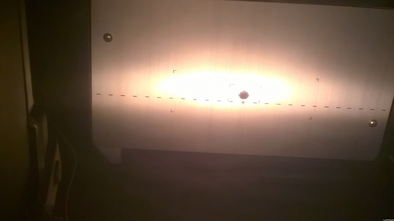

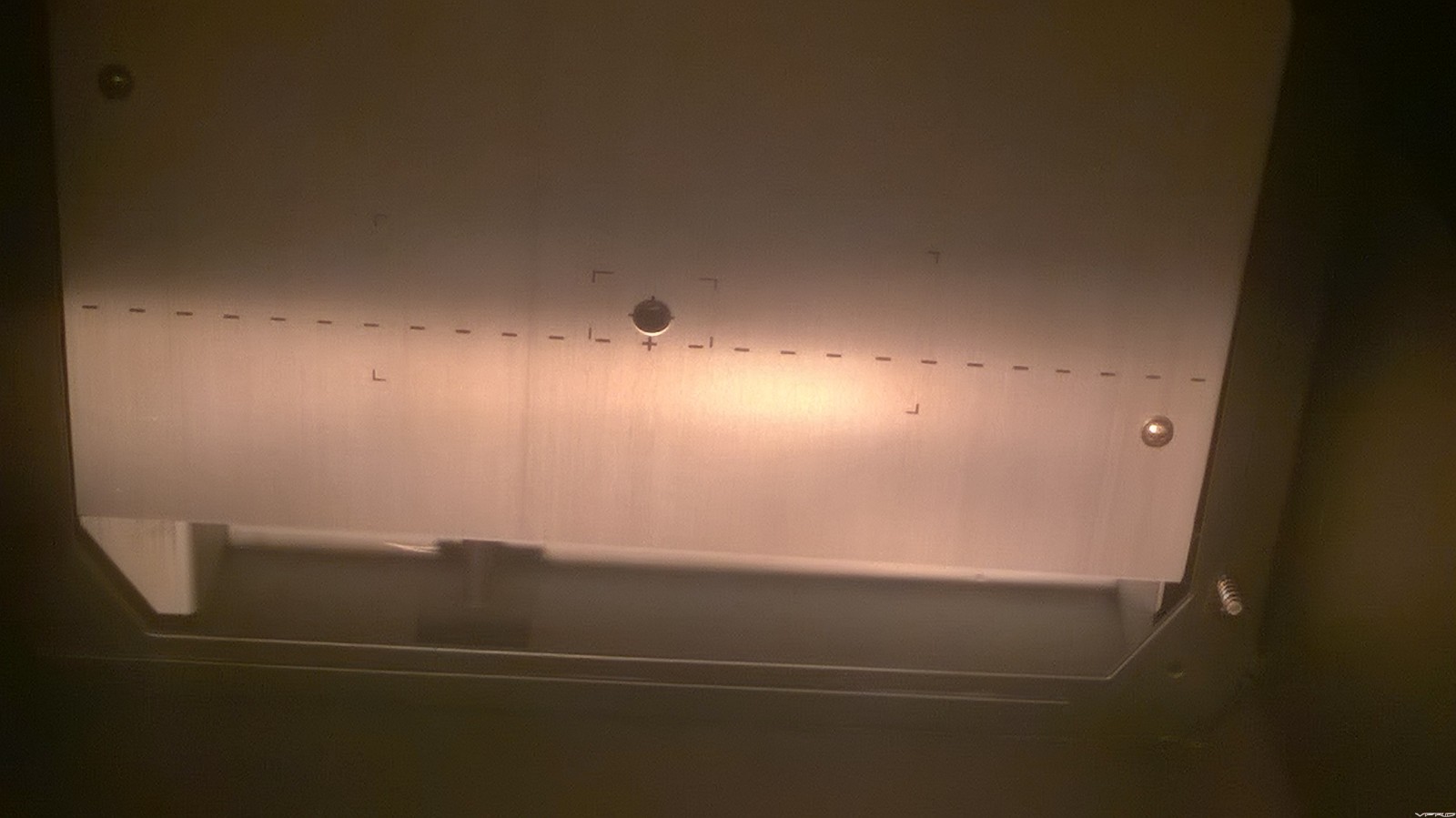

So I did wounder why the 3rd gen (as 4th gen) only has low beam in one side (aside Italy that only has one H4 bulb) and the more as there is 2 H4 bulbs, its "possible" to run low beam in both.
So first question is how does the "other" low beam look like. And as I have the opertunity to test it, I did.
So left side looks like this:
Low beam
and high beam like this:

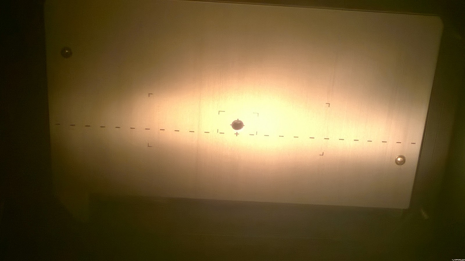

and then the right side. High beam
Looks much alike the left side.

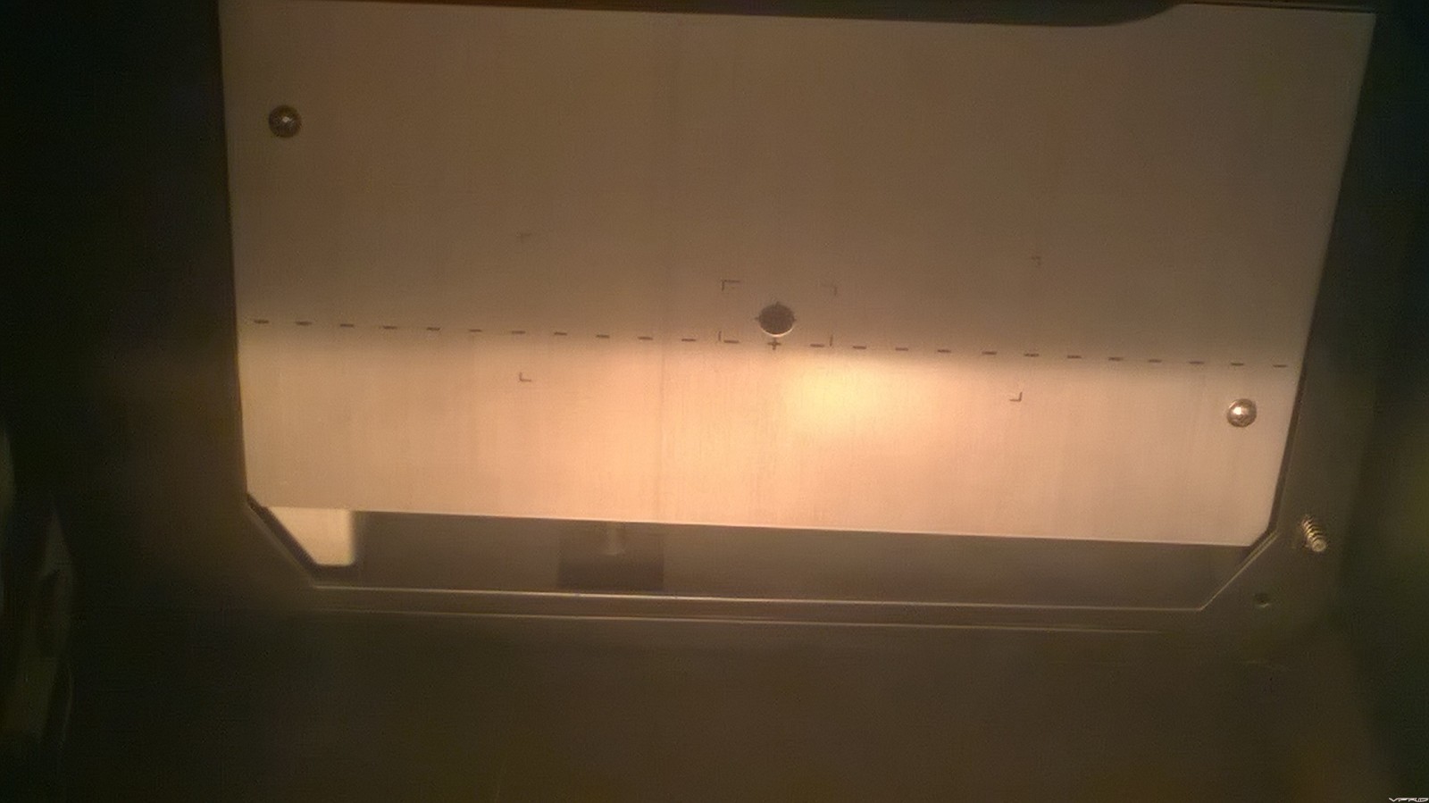

So then I did shift the wire sockels and the right side has a low beam like this
So also very much like the left side, a nice low beam pattern.
I adjusted the height to the same level, was not the fact but as adjusted separately no problem.
