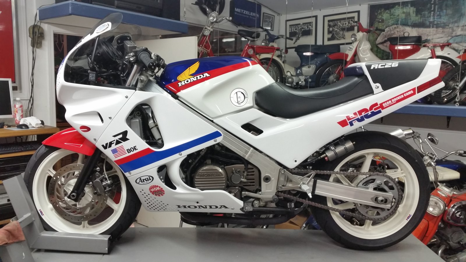

Been a few years of trouble free goodness.  The bike continues to be very capable and fun.  The need for new tires inspired me to put together a "RC26-II" Upgrade Kit.
[image: PXL_20250125_234025748.thumb.jpg.b298786a035388a6d777f5eca6b556c0.jpg]
Restored F3 forks with RT Springs.  F3 front wheel.  Brand new front Nissin calipers and pads.  F3 5.0" rear wheel with a matching rear caliper.
[image: PXL_20250128_015742681.thumb.jpg.70936c0a3d9ead5e9376921f818fa804.jpg]
[image: PXL_20250128_020104184.thumb.jpg.ab13a61e747e24354faef6f680696ef3.jpg]
New rear brake arm solution.  Real clean and simple.

Lovely. I can't even keep mine clean. 🙂
That is quite special. I'm quite envious. It all looks very nicely put together; neat lines and purposeful
Lovely 🤩🤩🤩🤩🤩
The bike looks fantastic.
