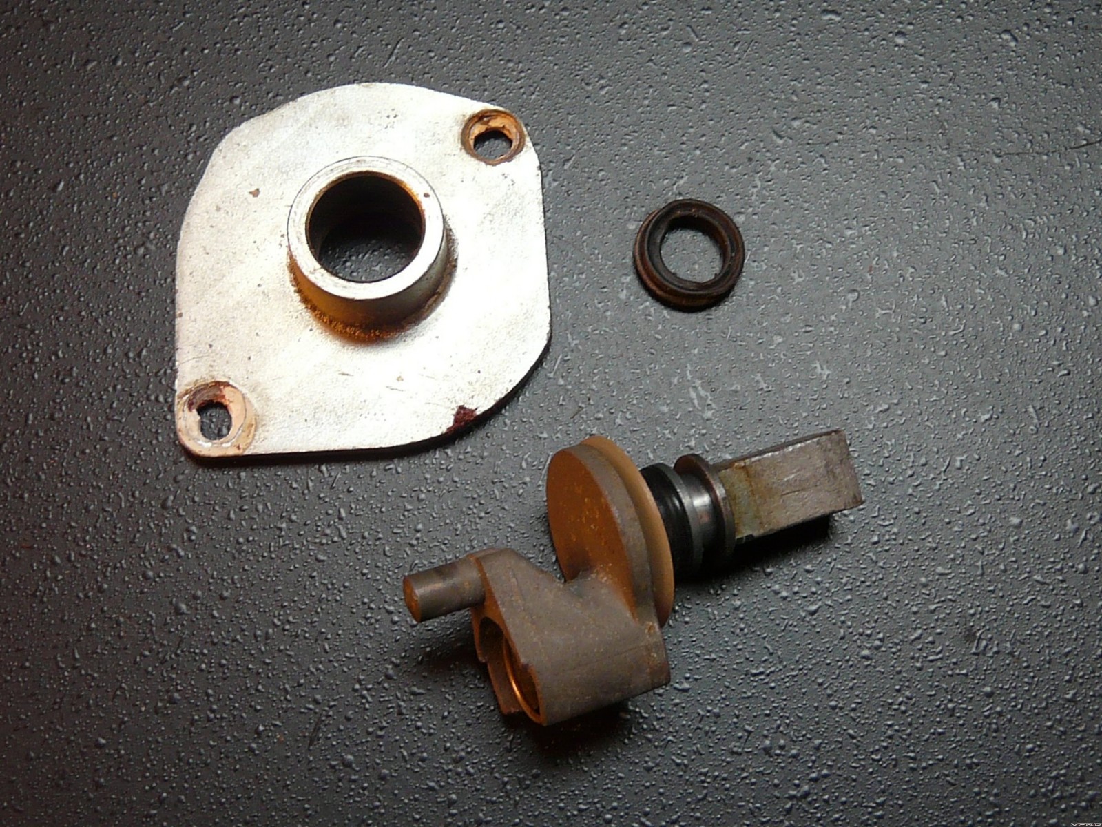

[image: gallery_5310_4809_17149.jpg]
There are two "square" section (with a small groove around the OD, similar to two O-rings vulcanised together) rubber O-rings. The seat measures 6,85mm ID & 10,0mm on the OD of he side walls. The seat width measures 2,2mm. The ID of the hole in the riveted plate measures 10,1mm.
Hope this helps in finding suitable O-rings.
If you mean the big o-ring between the petcock and the tank, it's approximately 24mm x 2mm (and still available from Honda). The o-rings inside the petcock have never been sold separately by Honda, but check out this thread. The sources listed there are UK-based, however. I had thought I had updated that thread with the dimensions of the internal o-rings, but clearly I did not. Maybe it was another thread... I ordered the petcock rebuild kit from NRP, which actually doesn't use special o-rings like the OEM ones shown above. Let me know if you need those dimensions. (But I wouldn't drill the rivets unless I was sure I needed to rebuild the petcock.)

Well, it's been six months plus, and I finally fixed the fuel leak. The  16958-KY6-003  O-ring seems like it did the trick. Been busy with all the BS of life and working on as well as riding the 7th Gen, so I was not in a hurry.....obviously! The old O-ring was brittle, and broke upon removal. Thanks again JZH and Rosso for the help!
