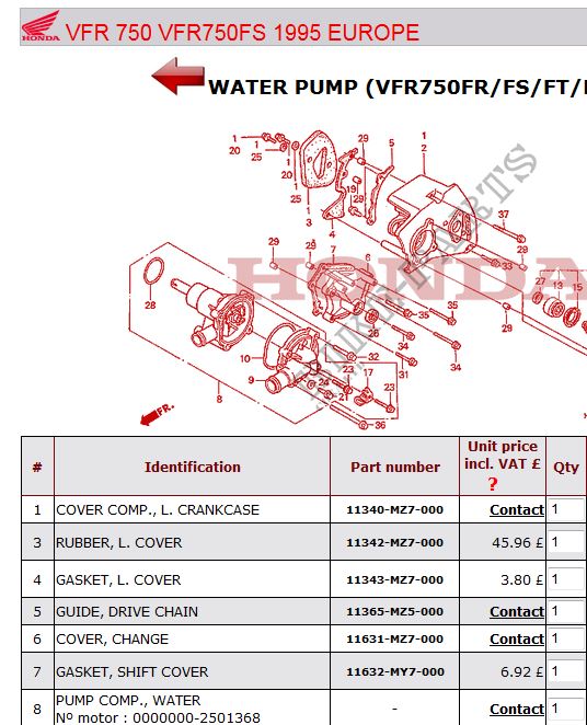

Went to Ron Ayers to get a part number, and...there's no price listed beside it? Are these things gone from The Mothership? A water pump??? C'mon...CERTAINLY these are still available, right?
Ron Ayers is showing part number 19200-MZ7-010.
Thanks Dutchy. New? Used? Should I even be asking this :-)?
Ohhhhh. I see now. Redslut has passed on to the moto Great Beyond.
OK. Let me pull the plastic before I get you to send it, just to make sure it's the pump. Might be a hose or o-ring. I'll do that this weekend...
