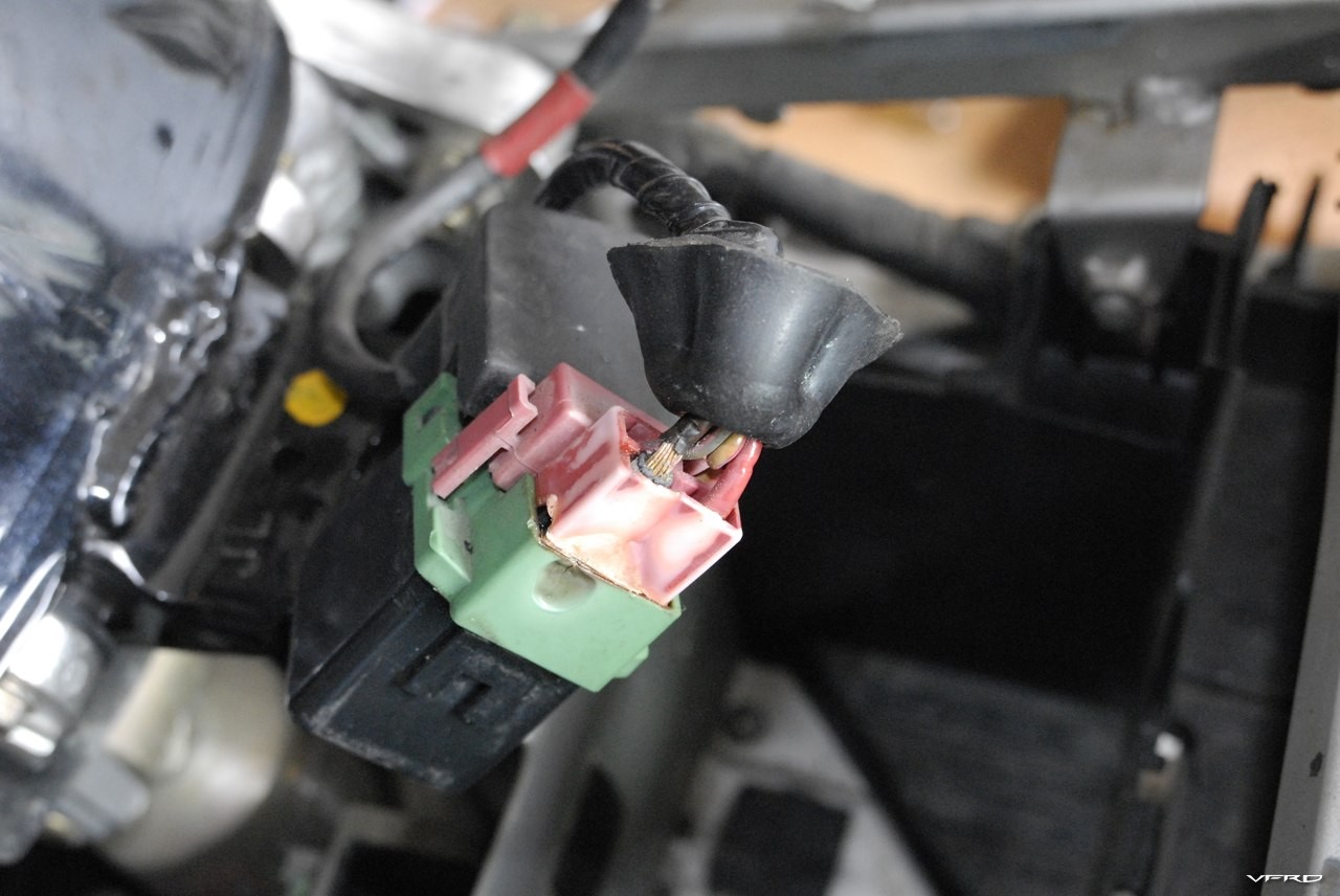

Another source of trouble might be the starter relay, adjacent to the battery. Output of the rectifier/regulator goes through it on the way to the battery. Here's a pic of the failed unit from my '92 VFR750:

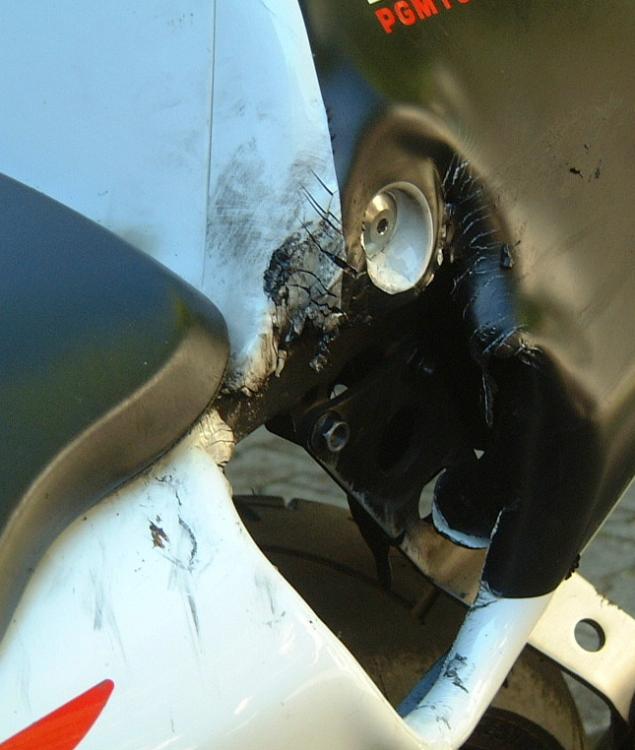

Be glad this isn't what it looks like:
That's Larry L's friend's RC45, post electrical connector melt-down... Expensive.
Holy sh1tballs x2!!!
