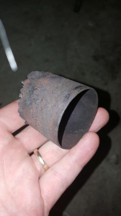

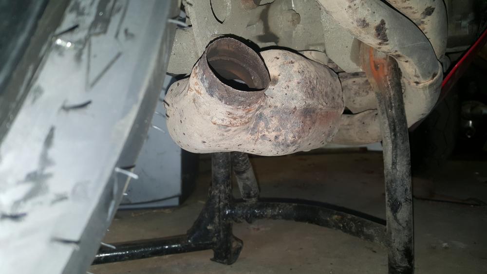

removed my rear wheel to get a new tyre on and when I was turning the exhaust to the side,
the pipe broke off. I'm sure some of you have experienced this before and I was looking for
advice to fix this issue.
I was considering using a stainless exhaust adapter like this https://www.ecstuning.com/b-ecs-parts/stainless-steel-exhaust-sleeve-adapter-55mm-od-to-25-id-no-longer-available/002497ecs01a/  but advice would be greatly appreciated if any of you tried an different method.
Thanks, Garville.
20170601_181439.thumb.jpg.abe66ced115c55a23472a2e273e2673f.jpg20170601_181408_001.thumb.jpg.406fb45085904d8eca4c0f8b82a5c605.jpg

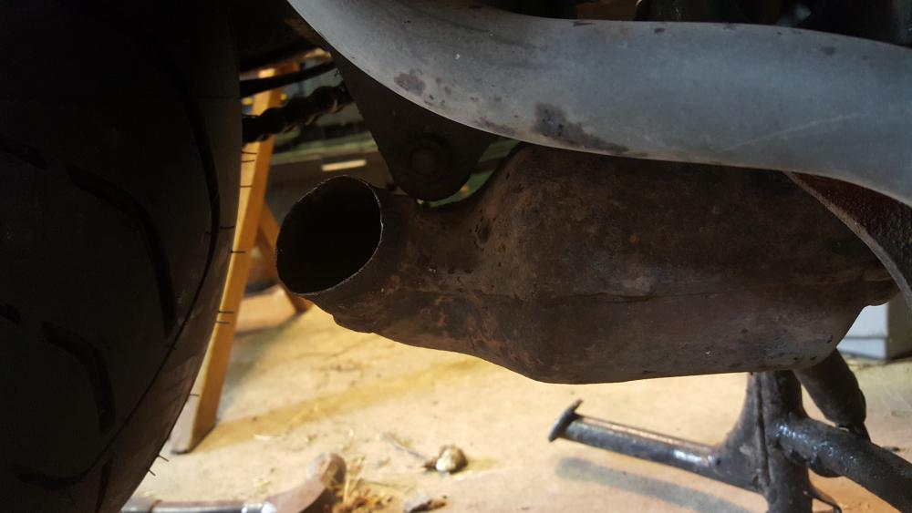

dang...  for my 2 cents, I'd suggest replacing the system...  if your header is rotted, so much that it crumbled off like that, then an adapter like you've mentioned is barely more than a band-aid....       holes will be showing soon enough..
Strangely the rest of the headers are not too bad, althought they look rusty.
Ooo,  sorry man,  this is if it's even on the side of fixing,  you'll need to get it off,  from that you'll know more if replacing the whole header is what it's going to take. No welding shop I know of will touch that.
ah where's your ingenuity  :tongue: :tongue:  . You may be right but I'll persist for now.
Huh... No easy fix there... Stainless headers are your best bet. For the price of new wheels you've got delkevic ones. Good luck. Keep us updated.

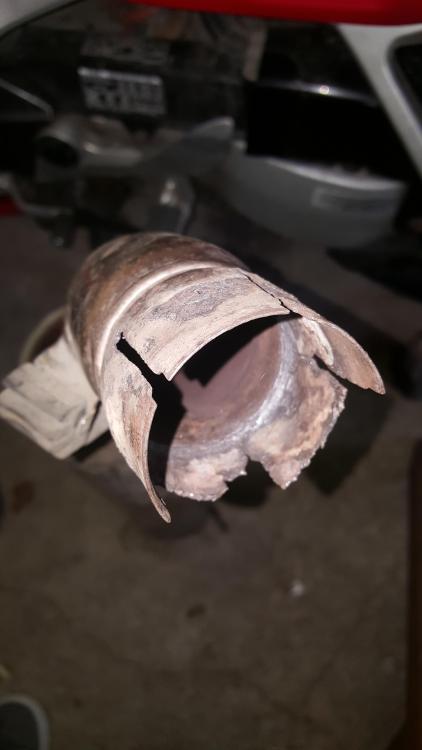

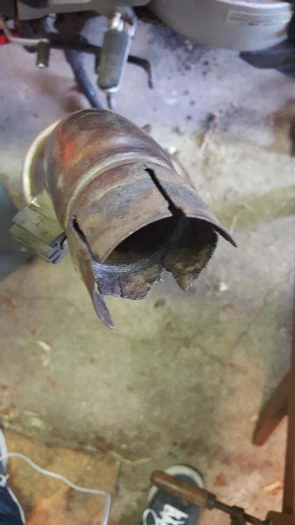

Ok so I tried to remove the old headers and the nuts for the rear left flange at engine mount is tricky as hell to get at, never mind removing it. After dosing the nuts in loosening spray over a number of days I managed to loosen all nuts but one which with an easy turn snapped off with the stud?.
I'm going to try an alternative fix for now.  Failing that, its off to a motorcycle garage cus it aint an easy diy job unfortunately. Also went to a local engineering workshop and they said if I could remove header pipes its an easy fix.....hence why I was trying to remove them. Plan B so.
