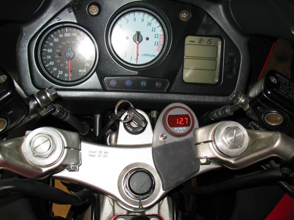

If you plan on installing a voltmeter, here is an example of the one installed a few months ago.  The toggle switch goes from voltage IMG_5231.thumb.JPG.c12ce8035c34a5196f6ca8de0236ef4e.JPGreading when ignition switch is on, and the other for reading when switch off.

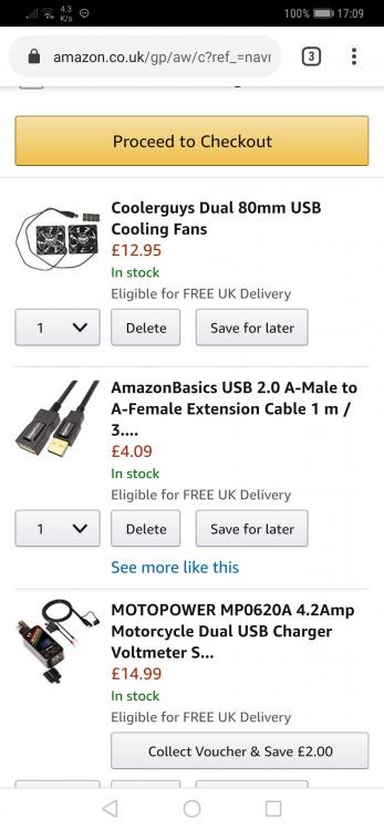

This is what I have ordered up, 2x USB cool fans for when at idle.
But also going to rig up the outher r/r for later date.

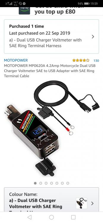

An alternative to installing a voltmeter on the bike is installing a bluetooth voltmeter that sends the info to an app on your phone. I just installed one on my bike and it seems to work well. Connects direct to the battery, lets you see charging voltage as you ride along. Assumes you have a phone mount but many people do. Might draw some current because it's always attached but I doubt it will draw much - and anyway it'll let me know if the charge drops by sending me a message! Product is Powertech Bluetooth 12V Battery Monitor for Smartphones (QP 2265) and I got it from Jaycar electronics here in Sydney, Australia. Good luck...

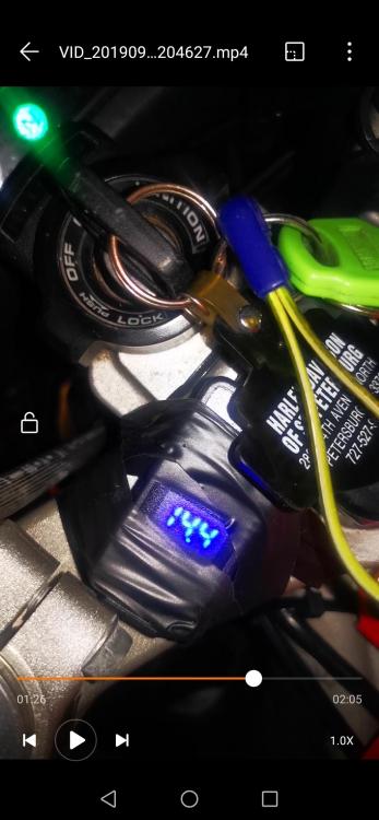

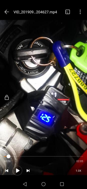

So far have fitted my voltmeter and added a on/off switch
So far it's about 12 to 12.5 and 14to 14.4 when running

For grins, my voltmeter mounted....
[image: assembled-Th.jpg]

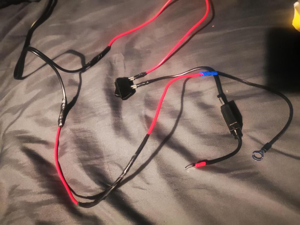

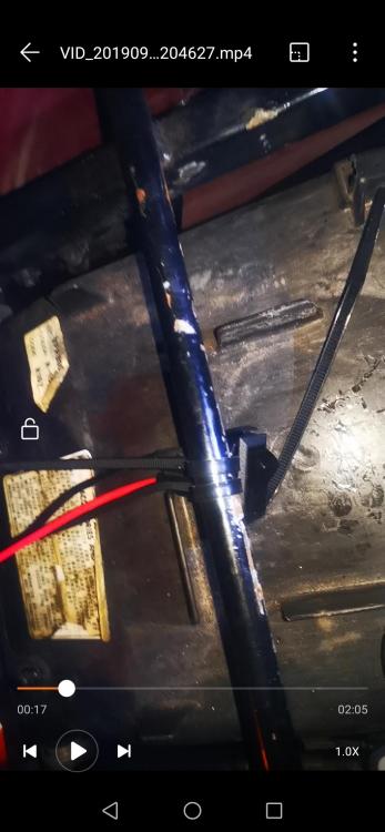

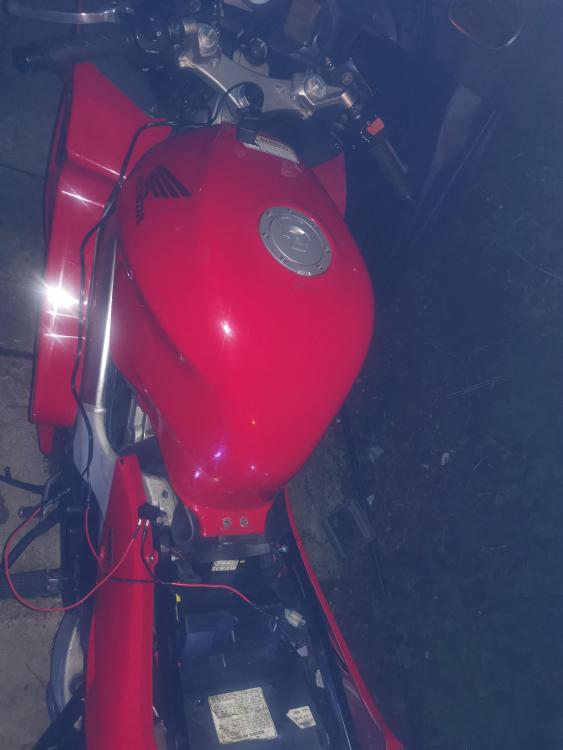

I got to work -
1) - tested the brown wire I could find at the tail light to check that between it and battery negative was 0V with key off and ~12V with ignition on
2) - Tested voltage across battery terminals and saw it was >12V (i.e. tail light voltage would not be a 'true' reading)
3) - Stuck volmeter on dash and fed cable downunder side of tank
4) - Used connectors to add more length to red and black cable from voltmeter
5) - Crimped the blue wire with a spade at one end and spliced the other with a tap connector to the brown wire at the tail light
6) - Made up a short length of red wire with a ring connector at one end and a spade on the other
7) - Made a short black wire with ring connector at one end and spliced in with the black from the voltmeter extension to a spade at the other end
😎 - Plugged the blue cable space to '86' on the relay
9)  - Plugged the red cable spade from voltmeter to '87' on relay
10) - Plugged the spade with the two black cables to '85' on relay
11) - Plugged the red spade cable to '30' on relay
12) - Connected the red and black ring connectors to appropriate battery terminals
13) - Stuffed the relay and any excess wire into the cavity to the right side of the frame (opposite the battery)
14) - Observe meter nice and dark with key off
15) - Observe meter firing up with ignition and reading exactly the same as multimeter over battery terminals!
Thats a win!!!!! (shame photobucket watermark obscures it a bit - but you get the idea)
