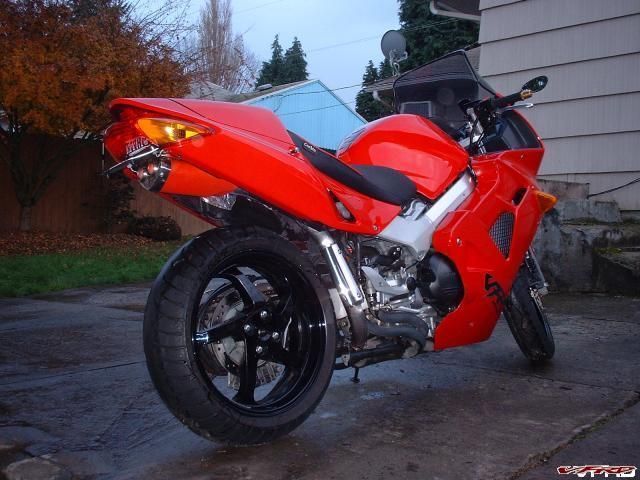

Here's some pics. I picked up the Wolf pipe a few weeks ago on eBay, without the underseat tray which I had to make from scratch.
I like the idea on the ceramic coated aluminum tray. I still have a roll of carbon and may try using my aluminum tray as a template to make one from CF once the temps warm up. Heat management is the real problem with this set up, I'm thinking a thin aluminum or carbon heat shield between the pipe and tray/battery box may be needed.

As Jim mentioned below we're working through some details to get the Wolf pipes duplicated. it's going to be at least a few more weeks but hoping to have more info soon, holidays put everything on hold.

Nice work mate, and some nice bits to go up front!
So, what have you done with the rear shock? Anything? I can vouch for an Ohlins to match the RC51 front smile.gif
WOLF WOLF nice
AB look at pic there is a remote res for the rear shock so looks like that's been done :biggrin:
Cool, nice job on the undertray.
Mine will look a lot better after it's been ceramic coated.

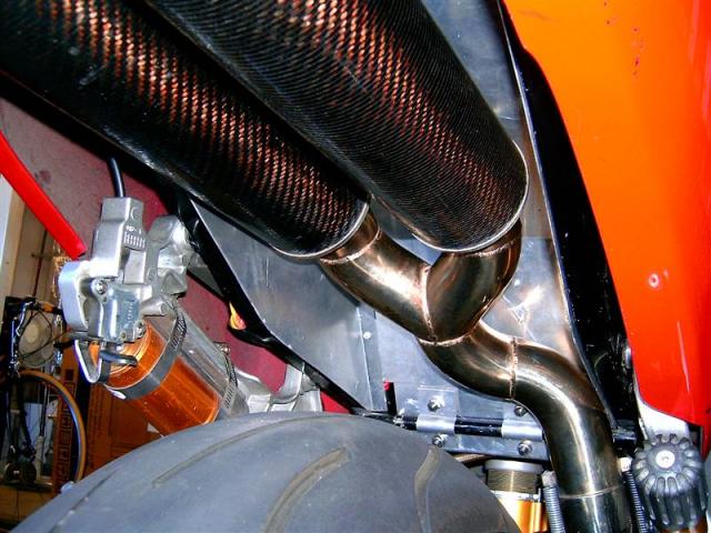

Also to be considered is the outlet diameter. Rob's Devil cans measured approximately 1 5/8" and the Wolf's are at 2".
I'm checking into using dual Laser Xtreme cans for the underseat application. I'm working on the overall dimensions to pass on to Cpn'.
The Wolf's pipes (2 piece) are chromed. Cpn is working on a single pipe application. One other consideration is the diameter of the inlet at the collector. I like Staintunes' application and I'm hoping Cpn is able to match that.
Cpn has been extremely thoughtful and considerate for those of us itching to grab a set. :thumbsup:
Hopefully after the holidays have settled down we will be able to inundate Cpn with mail.....

Probably doable. Magellan made his own single underseat system (below) and there was someone else too(?).
Oh yeah, it was VFRmonkey:
Get an outlet tip/end cap from a Micron oval can originally meant for a Ducati 916/996/998 and you're all set.
[image: 996_micron.jpg]
Micron USA will probably sell you one direct as spare parts.

I've been :lurk: ing here since this thread began, but it's been a busy holiday season... First off, great work among the fabricators here. It would be amazing if we collectively came up with the means to assemble a reasonably priced kit. I for one like dual outlets, regardless of whether that means two mufflers or one. It just fills the space nicely. License plate placement is another issue, especially if you don't like the idea of it hanging way down below your beautiful muffler mods. That's the reason I went with mine above the muffler, even though it unfortunately obstructs the rear view of the muffler a bit.
The reason I eventually abandoned my underseat setup for the tok tokkie underbody design was that I ride two-up all the time and we were hitting the pipes and muffler with the rear tire on big bumps, sometimes hard enough to send an impact up through the seat. Another problem I had was melting bits on the undertray. I tried to cheap out and modify the stock plastic undertray, which later melted in several spots (despite heat-resistant sheeting between the undertray and exhaust). Last but not least, the muffler guy I used did a hurry-up job on the mid-pipe-to-muffler section with mild steel, and after seeing veefer800canuck's stainless and Wolf mid-pipes, I'm pretty underwhelmed with mine.
So I built one like tok tokkie's last spring. After living with the underbody system for a season, I found it had several significant drawbacks (not that I think tok tokkie is anything but brilliant for designing it!!), so now I'm back at the drawing board... again... <_<
At this point, I'd recommend the following for any complete underseat system: An undertray made of thin ceramic-coated aluminum (I think Rob would agree that even thinner sheet than he used would be fine) with as much room as possible underneath for the bend connecting the mid-pipe and Y-pipes (it needs to be as *up-and-forward* as possible to avoid tire contact later. Ovalled pipes (much as on the 6th gens) would be the best solution yet. Carbon-skinned cans would be best for limiting heat transfer. The grommeted stays for the tail plastic (at the back by the lights) need to be replicated to avoid cracking plastics (as happens with Wolf systems unless modified). Re-positioning of the CPU is required. Shimming the shock (especially if you ride two-up) will likely be necessary, no matter how compact/ideally routed your system is, to avoid tire-to-muffler/pipe contact over big bumps. License-plate location is still an issue, maybe one best left up to the individual (I recommend Lite 'N Bolts for license-plate lighting).

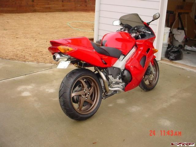

I have a full set of RKA soft bags that came with the bike, previous owner said worked great it the carbon Micron.
[image: P1010733.JPG]
[image: P1010731.JPG]
F&F

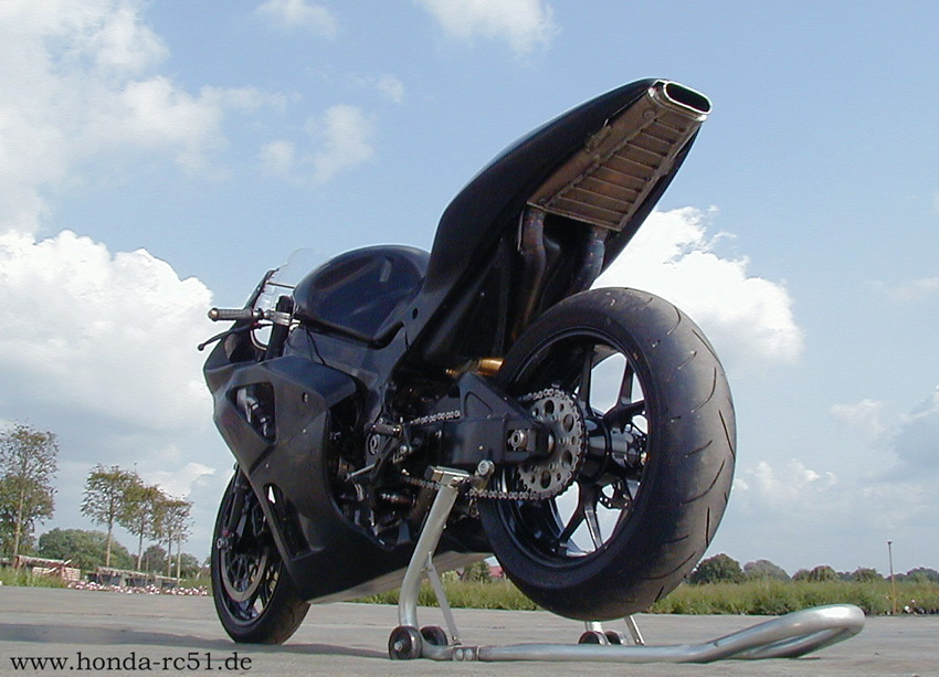

Did you see the link I posted yesterday to that RC51 underseat zorst? I'd like to see summat like that on a VFR. I'd volunteer to be first, but first I'd have to divorce/kill my wife....
Here we go:

What is the diameter of the exhaust piping that goes from the header section to the mufflers? Is it all the same on all generations of bikes? Just wondering if it a standard 2" diameter exhaust tubing?
what's the clearance with the original wolf undertray/setup i.e. are there any rear wheel/exhaust issues ?
perhaps I can lay my hands on a original undertray, for what it's worth
Rolfwhat's the clearance with the original wolf undertray/setup i.e. are there any rear wheel/exhaust issues ?
I scored one from a bikepics member. I didnt want to hack up the original undertray, so I bought another so the bike could go back the way it was. I "did" use my existing T/B muffler as a gineau pig. You'll have to shorten the muffler by aleast 3.5inches......and fabricate some kind of hanging bracket for the muffler. The most important thing is to cut the undertray so the muffler will fit. A muffler shop bent the pipe for me. but I left the muffler installed on the bike so the guy could mate them up. The only issue that I had was plate placement. I had it too far under the bike and the rear wheel bent the shit out of it LOL.... I moved it out towards the tip of the muffler and I'm all set. Oh yeah, you'll have to rig up some kinda plate light. I dont know what kinda muffler you have but I had to get a ducati end cap that fit the C-5 can so the muffler exited straight out instead of off to one side.......it looked kinda stupid. Look in bikepics.com. They is a guy in there(Brad) who did this. I contacted him and followed the mod to the "T" One other thing, fab up some kinda heat shield for the muffler and pipe. I made the mistake of winging it and burned the under side of my NEW sargent seat!! I was lucky it didnt burn through. I screwed a heat shield to the seat and wrapped the exhaust pipe. Right now it's good. I'm still not done though......I still have to send out the mid pipe to have it smoothed and chromed. but it looked good polished. I will see if I can send a pic..... Not good at that. I do have one up on vfrworld.com. It's under harricanfloyd posts...... I know this was a little long, but hope it helps!!
