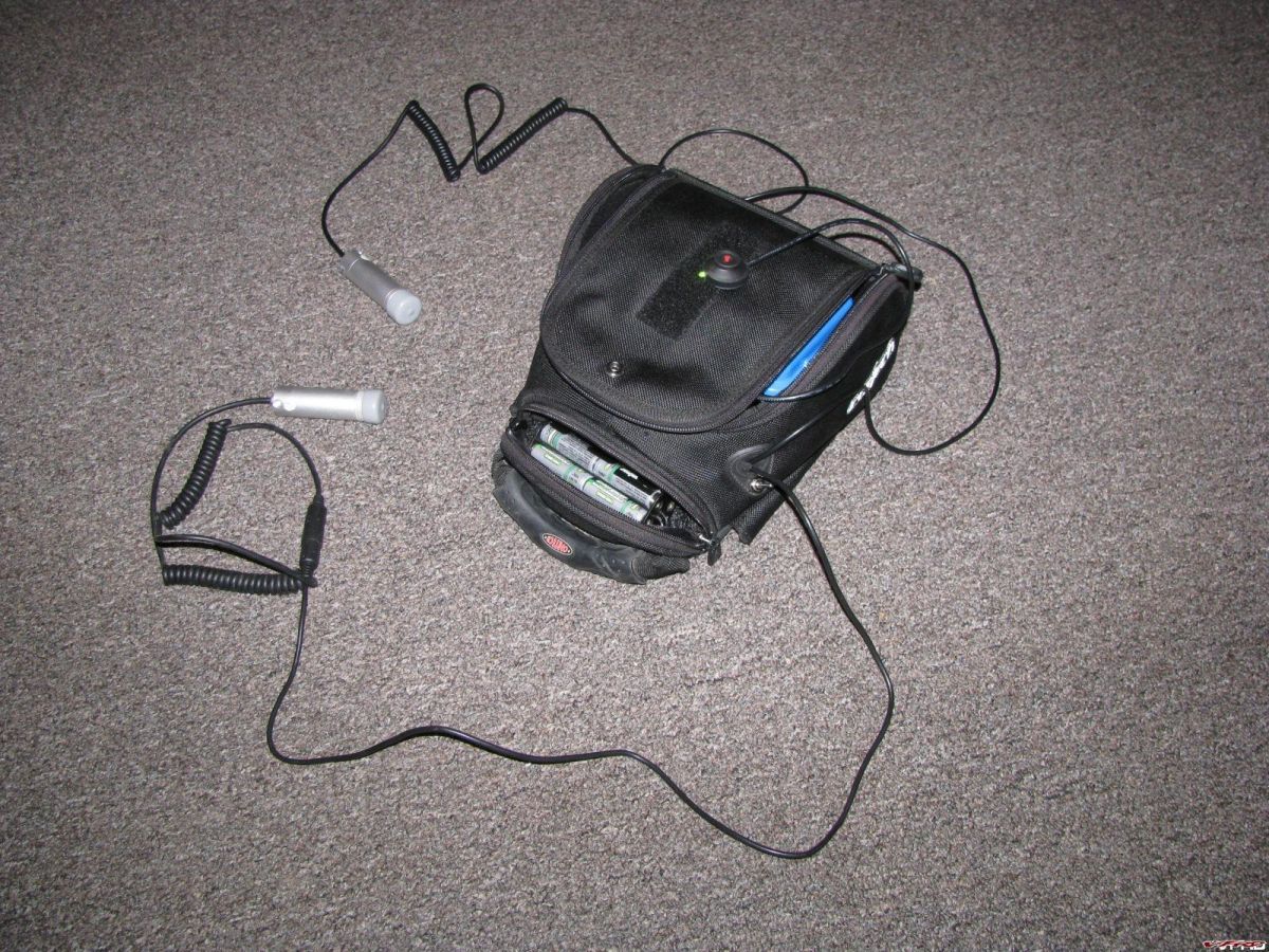

http://www.viosport.com is the camera set I chose I have the ADVENTURE CAM 3 two of them, I bought seperatly. I like them they do not however have a protective enclosure and the mounts are inadequate. SO I took the best of each of these companies and made my own. They have a new digital DVR that looks like it would be perfect for motorcycling too called the POV1

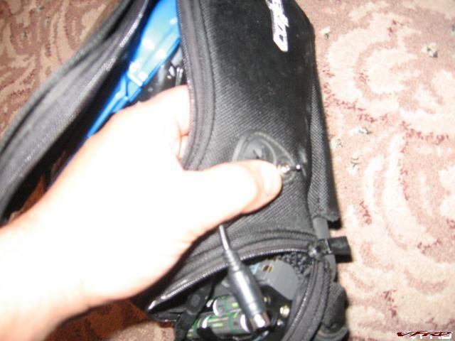

as far as my two camera setup I took apart the power connector/microphone on one and soldiered in another so I can flip a switch and change cameras on the fly, and I use a mini codura magnetic tankbag and a I have my cannon mini dv recoder inside a pelican case to keep out the rain or should the tankbag fall off. Trial and error mainly on the setup. I even bought a miniture multiplexor but it was too bulky once you wired it up for use. The switch Idea was perfect for me. I use ram mounts for the cameras or the plastic clips I got from bulletcam.
viosport cams bags batteries and cameras
The switch I wired up a switch, its on the wrong side, it orginally for for a mp3 player where I mounted it so I turn the bag around backwards to operate it with my left hand.

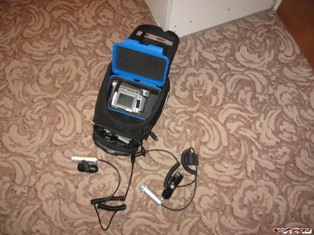

I have a new/old camera, the canon zr300 went kaput, so I found a sony hc30 on ebay. I prefer this camea for its small size and because it has a Lanc port
my setup is as follows
  • Sony DCH30 mini dv
  • 2 x Viosport Adventure Cam
  • Lanc version 1.6
  • Pelican 1050 microcase
  • custom made dual camera switch/high gain mic
  • audio splitter
  • cortech mini magnetic tankback
  • eveready rechargable AA battieries

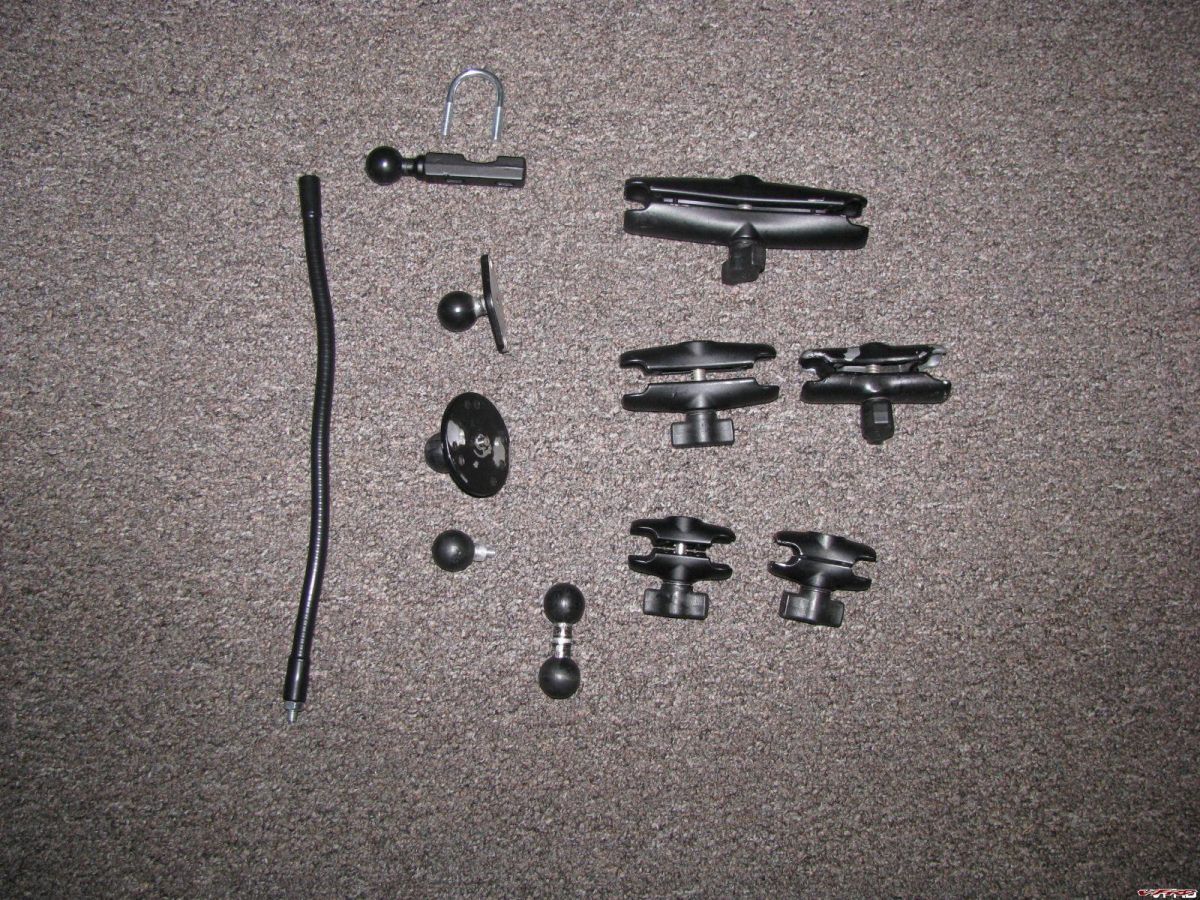

Ram mounts
Camera set to go
The Lanc is nice you can shut the camera off and on, pause and record by one button, depending on how long you depress it.
