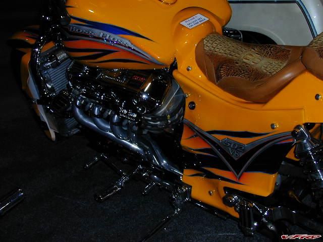

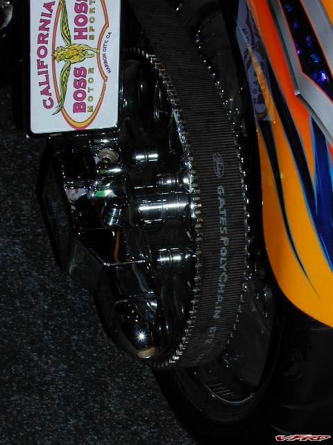

Belts are stronger than most people believe... take 37mm wide 14mm
pitch Gates Poly Chain... it is strong enough to handle a 502 HP 425
Ft lb Boss Hoss... in fact most of the Boss Hoss product line employs
belts...
You'd only need a 30mm wide 14mm pitch belt to handle 172 /90ft lb
V4 which is only 5mm wider than a 630 chain...

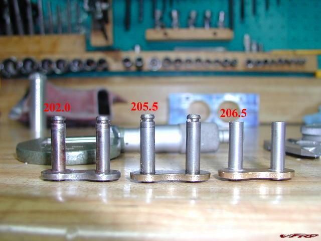

No one can dispute the fact that automatic oilers do not replenish the
factory lube at the critical pin and roll junction behind the X
rings... my customers swear their chains are good at 30K miles this
until I show them the wear hidden from view...
This is what you don't see behind the X rings... metal to metal wear
every time you adjust the chain that eats into your engine's available
HP... 206.5 is new 205.5 is at the 8K mile mark... looks good but
multiply 1 thousand of an inch times 108 links and you have 108
thousands of an inch wear or about the range of the green marks
provided by Honda's wear gauge... 202.8 show the very visible wear at
the 12K mile mark... just think what those pins look like at 18K... so
you still don't think that is chain abuse???
