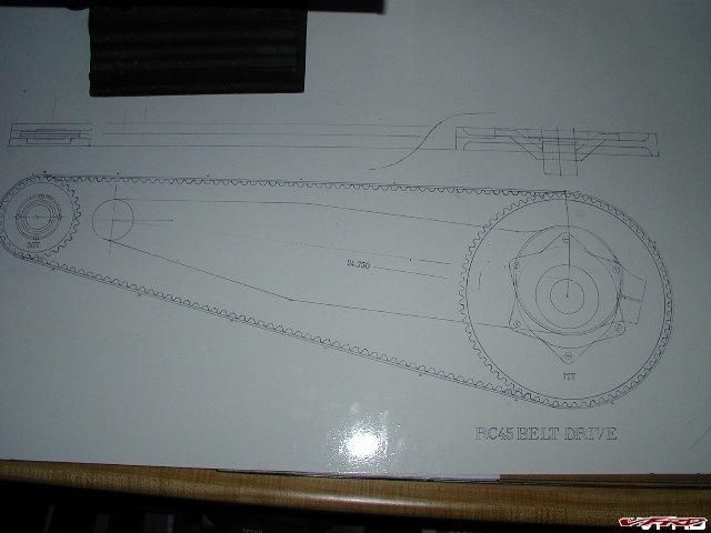

pain... belts spell relief... and so my belt drive conversion starts with an
engineering drawing...

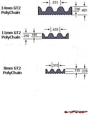

Gates Poly Chain comes in 3 belt sizes... 14mm pitch is what HD
employs on their cruisers... 8mm is what I used on the VF500
Belt-0-Ceptor... 11mm is the little known in between belt but only
comes in lengths of 155T and 172T... I need 166T to make it work on
Mr.RC45...

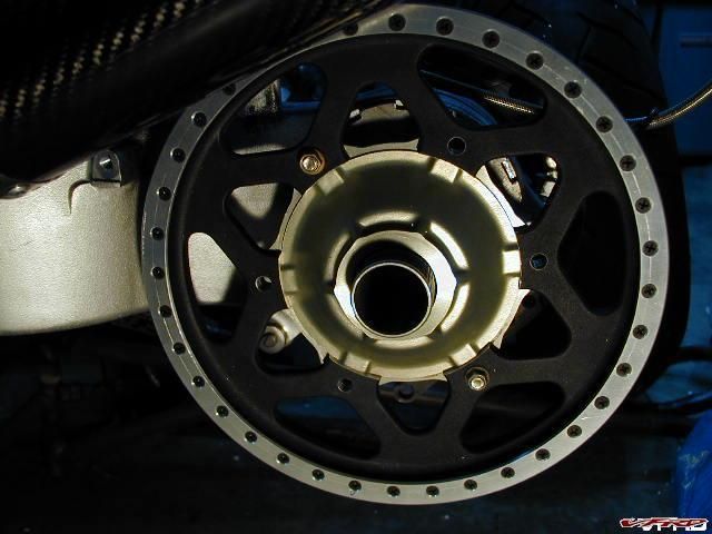

Buell's aluminum 72T 11mm sprocket installed on the RC45 axle...

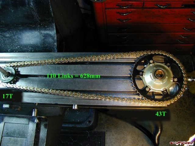

Ideally I needed 628mm between centers as evident with Mr.RC45's 17T
43T 110 links of chain prove to show...

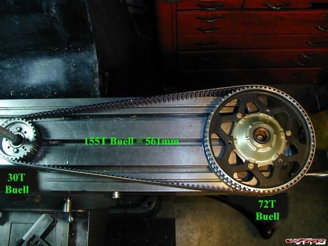

But when I added the Buell 30T 72T 155T setup it measured 561mm
between centers... 67mm too short...

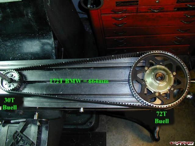

Next I ordered a 172 tooth belt from BMW but with the Buell sprockets
the BMW belt was 664mm between centers... 36mm too long...

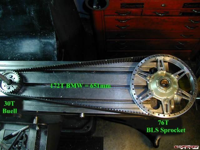

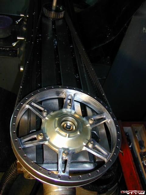

Maybe if I machine my own 76T sprocket so I started with a 20lb block
of 7075 T6 Aluminum...
[image: gallery_3131_51_62149.jpg]

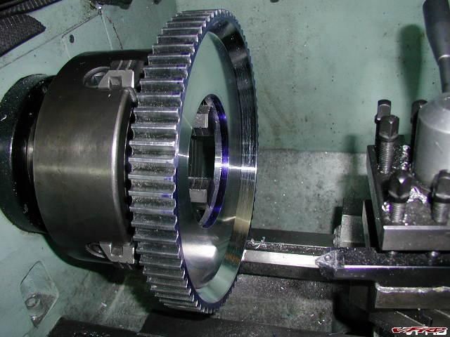

After the teeth were cut by RCD Engineering the block was down to 10
lbs at this stage...
After milling the spokes using only hand eye coordination it was down
to 1 lb 13 oz...
Now with the Buell 30T sprocket 172T BMW belt and 76T home made
sprocket the distance between centers was 651mm... 23mm too long...
because of the single sided swing arm I limited to 20mm adjustment so
I knew it would be close... how close??? less than 3mm or .118
thousands of an inch separates success from failure...

SEBSPEEDGuys, look at the pics. Belt might not clear the swingarm under tension. sad.gif
The Buell sprocket (3rd photo) seems to come real close to the swingarm!! So I'm not sure if you've placed the custom-made one to check, but with 4 more teeth it must be getting close to touching... unless the photo is deceiving...
Hopefully Larry is trying to obtain his required measurement with the axle & hub oriented as far forward as possible... in the case that the belt doesn't stretch, he'll have the shortest wheelbase possible.
That'll allow him to gain a couple mm by moving the eccentric...

Thanks for the questions Toro...
I stretched them out and measured the centers of the 110 links of
chain and the 17/43 sprocket on the milling table... then I stretch
and tensioned the belts and measured their centers... I also produce a
full scale engineering drawing as a second opinion... it would be nice if
Honda would release the engineering drawings to the RC45...
