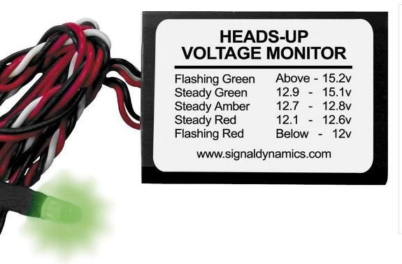

Signal Dynamics LED volt meter
[image: sdc.jpg]
The Signal Dynamics LED voltage indicator is extremely nice.  I have mine attached electrically to a switched contact on my VFRness accessory fuse block.

the Signal Dynamics set-up is by far the best voltage monitor i've seen.

The thing about the Signal Dynamics LED is that the range of green is way too wide - 15.1 - 12.9 volts. So you could be running all day or all vacation in the green and still end up stranded by the side of the road.  With a digital, you can watch the trend of the health of the system and get a handle on preempting a problem if something pops up. Low 13s and 12.9 volts consistantly will get you stranded. Any Amber reading other than idle - chances are your hosed.
[image: SignalDynamicsLED2.jpg]
