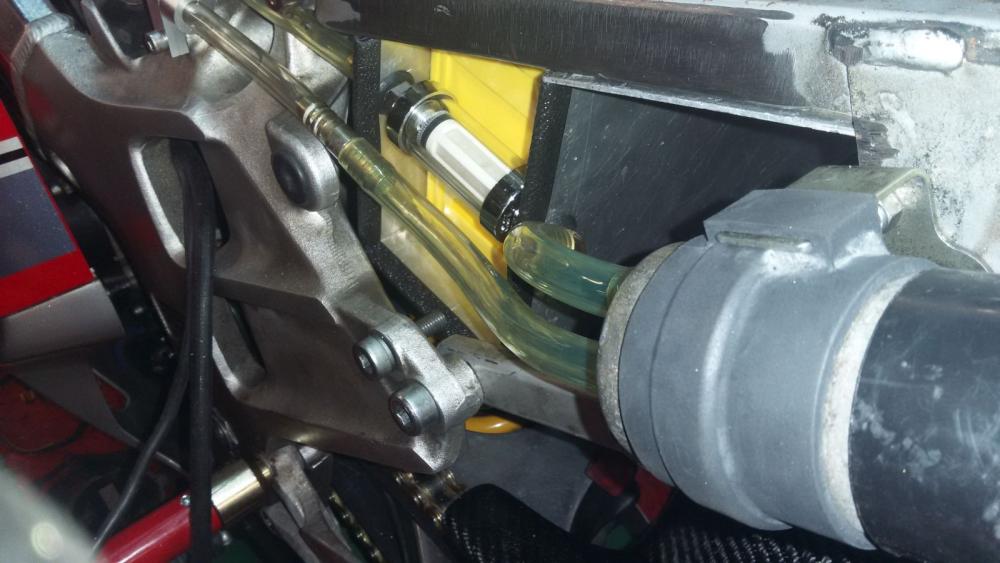

In case it helps someone, I recently found some really nifty stainless steel fittings in the correct size for 3-4th gen VFR fuel lines (5/16" -- 8mm) at Beverage Factory in California--including a tight u-bend that is perfect for replicating the 180-degree bend in the OEM fuel line (from the tank).
[image: tn375_large_ssu-c2-s-u100109223243.jpg]
I use polyurethane clear tubing (a Tygon-type) for my fuel lines, but it should work with conventional rubber fuel line as well.
[Edit: I should have said, some of the VFR's fuel lines.  The fuel pump takes the larger 3/8"  --  10mm size, but the hose barb on the tank petcock is the smaller size.  I have forgotten what size the lines at the carbs were originally (mine is currently 8mm), so, as always, best measure before buying!]
Would be interested in pics of your install
3 hours ago, SEBSPEED
You and me both!   :happy:
This was the way I had it last year, but I've started over since then.  Instead of the Beverage Factory u-bend I had the tank output line doing a lazy loop towards the front of the bike, under the PCV hose on the rear cylinder head cover and then back to the fuel pump.
But that was then.  Now I'm working on a completely different undertray design--why do you think I bought a TIG?   :wink:
...and I've also now got that nifty stainless u-bend, which will eliminate the need for that big loop (Tygon doesn't like right bends).
