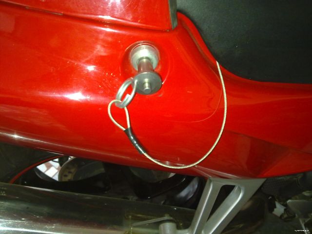

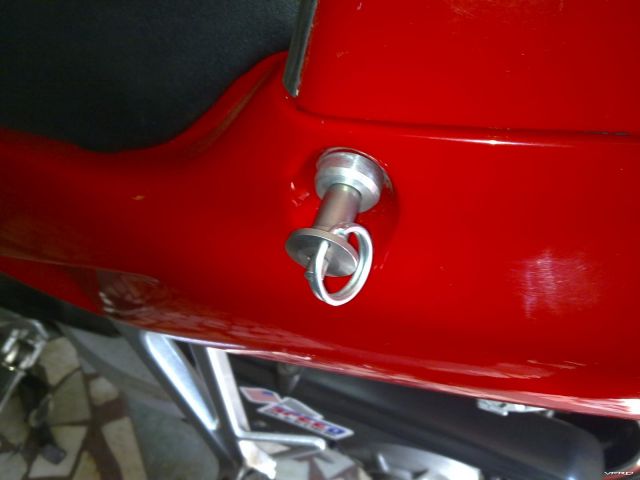

after i fitted the Givi Top case rack realized the seat cowl can't be easily taken out. earlier i had the press release pins on the cowl
Final cowl touches
Final cowl touches

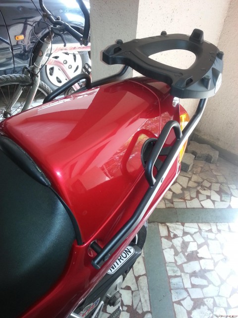

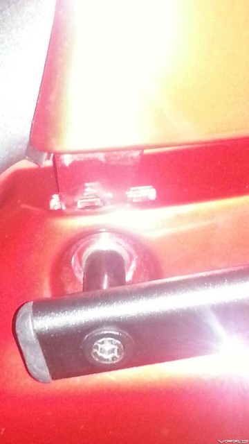

Now with rack fitted ...
00. Givi Rack
00. Givi Rack
  01. Rear cowl Cant Fit

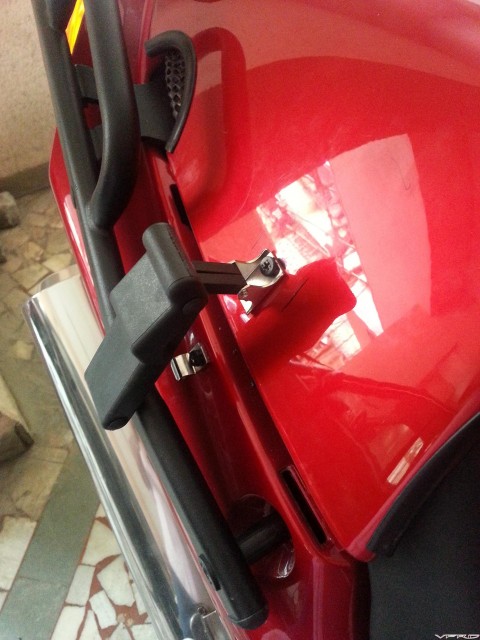

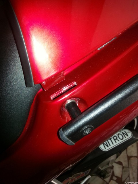

  So trimmed out the tabs..   02. Rear Cowl   front Tag trimmed

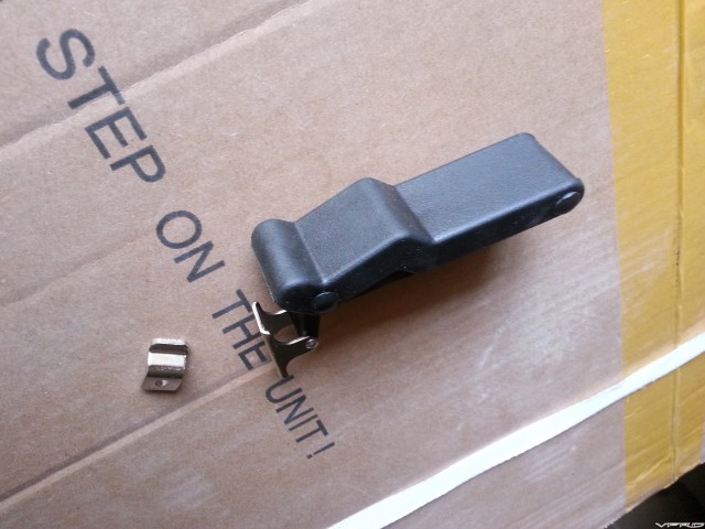

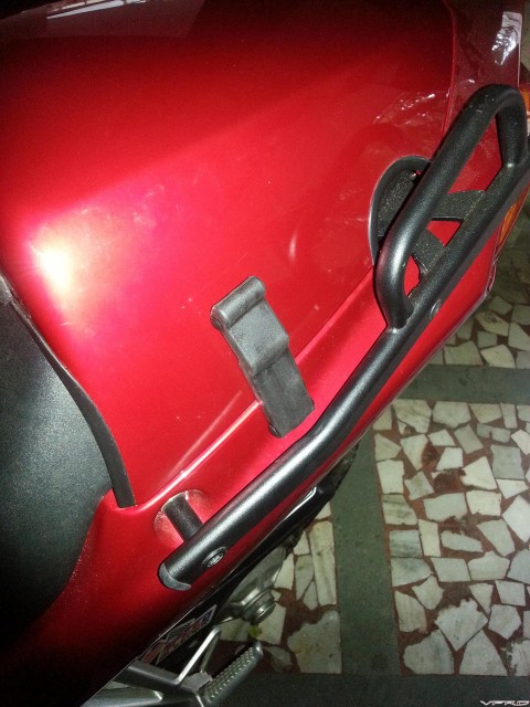

This allows me to fit the cowl without securing it to the bike.   Purchased couple of Rubber latches...   03. Lock For Rear Seat Cowl

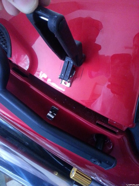

and mounted them on the rear tail cowl and the seat cowl..
04. Rear Lock alignment
05. Lock On Reat Seat Cowl   checking Fit

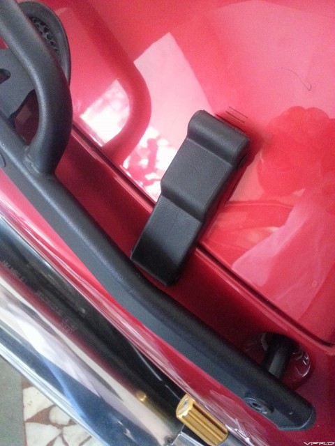

06. Lock fitted On Rear Cowl

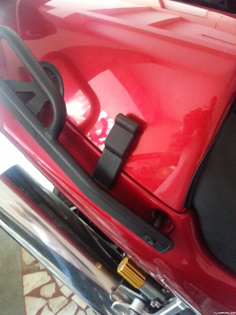

07. LEft Side Lock On Seat Cowl
08. Right Side Lock On Seat Cowl
Alignment took sometime but eventually got there. This is quite secured and can be taken off easily.

These are bonnet latches. after a lot of searching purchased them from good old ebay.
there are two types - i purchased both but used only rubber bones.
http://www.ebay.com/itm/290903532493. (USED THIS ONE)
http://www.ebay.com/itm/230778341819
