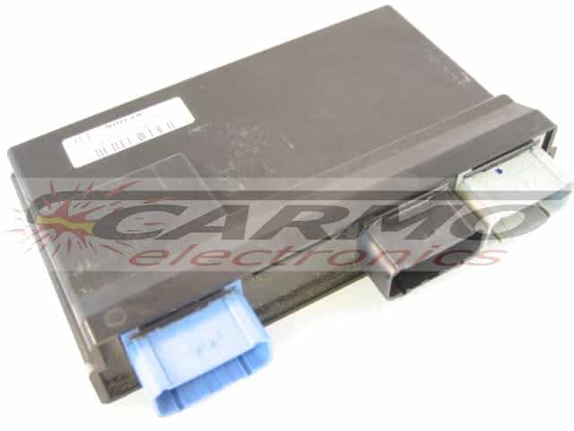

Are there any guides on how to Mount/dismount the ECU? Preferably With Pictures. I can't seem to find anything. I might just be blind though...
It's quite simple, you need to lift the tank, then it's directly above the airbox.
You will find a black module there, approx 15x7x2cm in size with 3 big connectors at the bottom, the module itself is placed vertical and it attached with a clip to the airbox.
That is the ECU.
It looks like this:
[image: VFR1200F%20%2838770-MGE-644%29.jpg]
Optimus Prime I guess
lol, Now I am going to say that in my head everytime I see it.
That is the ECU.
It looks like this:
