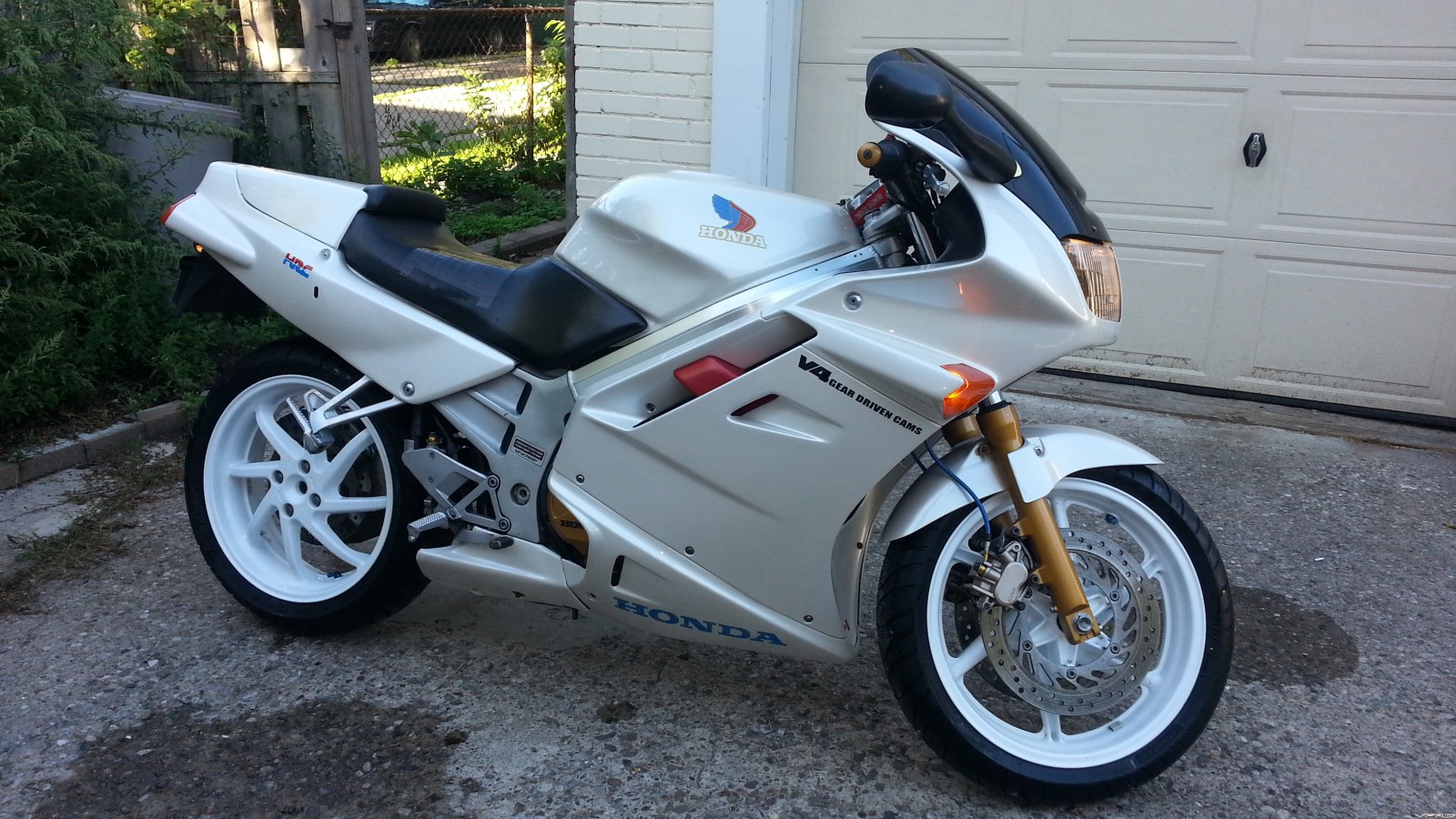

who wants to buy the VFR?
PS. it now sports a Corbin saddle that I haven't even ridden in yet!!!!

gallery_19685_7129_1425432.jpgPS. it now sports a Corbin saddle that I haven't even ridden in yet!!!!

Based on the number of people looking for an 8 spoke wheel, you can probably part it out and start with the wheel, lol
All joking aside, sometimes stepping away from it helps. Good luck with whatever you decide to do.
