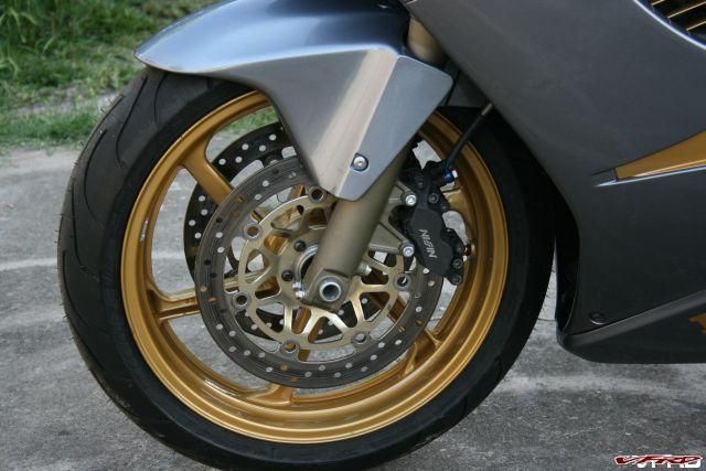

zRoYz used "F4i forks, F4i calipers, F4i master cylinder, F4i guard, 6th gen triple clamps, 6th gen clipons, 6th gen wheel, 6th gen rotors, 6th gen axle", and this is how it looks:
Those are a lot of parts to gather, but he'd be buying the same number of parts for an USD conversion.  The 6th-gen triples have exactly the same offset as the 4th-gen, and the forks approximately the same length, so there would be no significant suspension geometry changes to deal with.  I think the F4i conversion is a nice, sweet upgrade (and I wish it had been available when I did the Firestorm fork swap on my 3rd-gen).  YMMV...
I also think that the f4i front end swap is a great upgrade for vfr's. It is especially a great bang for the buck on 6th gens as 6th gen triple trees/wheel/rotors/axle will readily accept f4i forks.
But on earlier vfr's where the triples will need to be swapped out in order to run f4i forks, it makes less sense to go f4i than upgrading to a modern usd/radial front end, especially on the 4th gen where the wheel/rotors/axle/etc need to be swapped and you dont have to deal with delinking the brakes.
