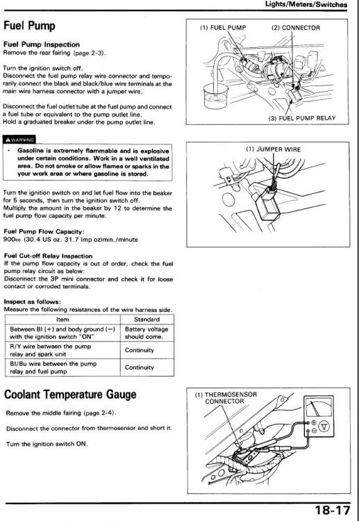

I was hoping to get it started today but it didn't happen. I'm not getting fuel through the fuel pump. I'm suspicious of this fuel cut relay. I have power on 2 wires with the key and ignition on, at the relay but no power on the third. I'm not 100% sure what to test but I would think the third wire should be 12+ to the fuel pump. Can anyone confirm? A new oem relay is $48. [image: 6c62e7ff6dd1d3491d14832233edaaab.jpg]
Ran a wire from the battery to the fuel pump and it works but it seems too loud to me. Is it supposed to click, click, click like that. I had the fuel end running to a bucket so maybe it was just trying to build pressure and couldn't. It should turn off once the floats close and there is some back pressure right?
I tried testing by jumping from the blue wire at the fuel cut relay to the red wire but that didn't work even though there is 12volts with the ignition and run switch on. But when connected that drops to like 2 volts. What am I missing?
Sent from my SM-G900V using Tapatalk
the full story
Thanks@Dutchy I jumped the wrong wire. Jumping blue to blue/black worked. I do have continued between the spark unit and red wire so the fuel cut relay is bad. Question can I just wire a standard relay in or do I really need they OEM relay?
