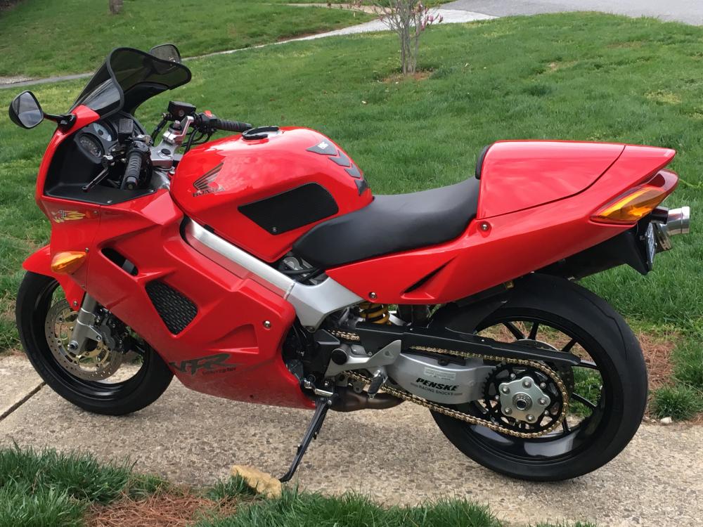

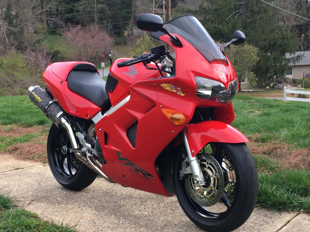

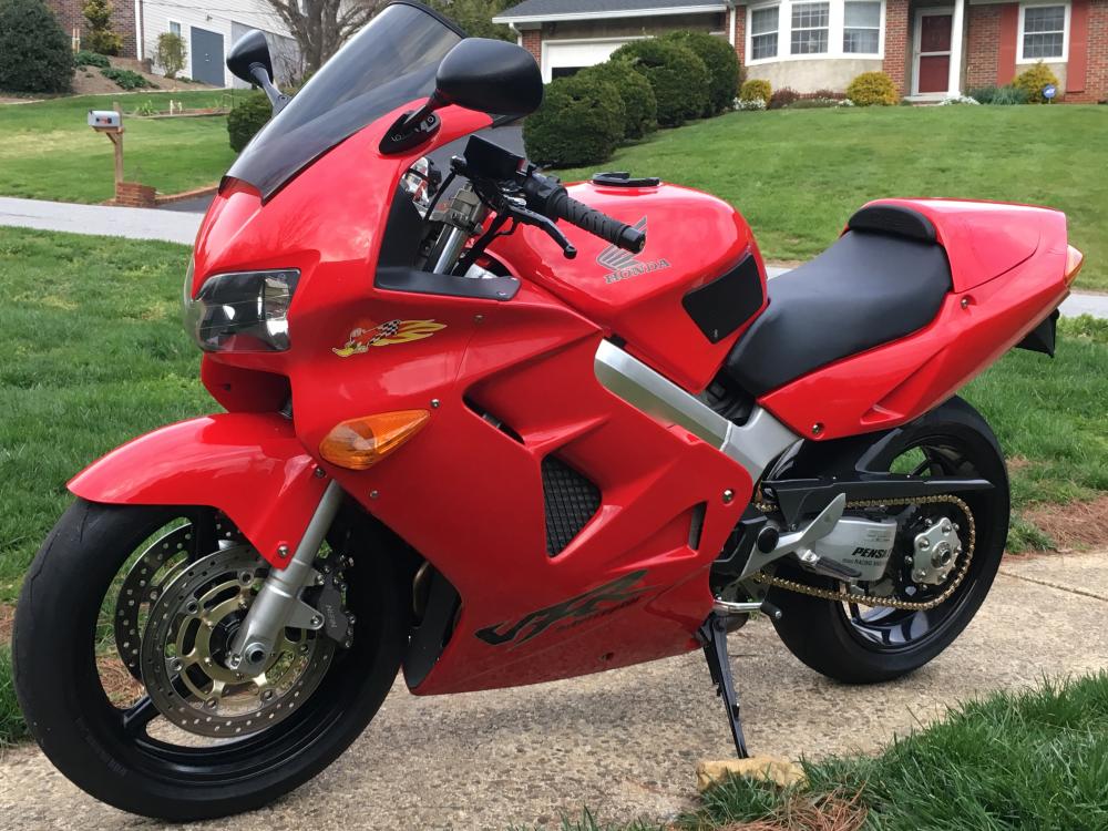

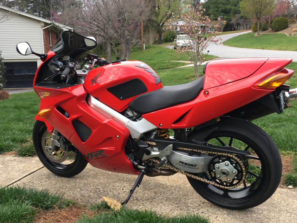

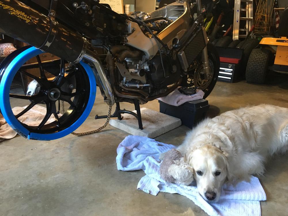

My winter project was a front delink that turned into a delink and 848 rear conversion. I had help from the forum, Rush, Mohawk, Keef, Mellow, and others, Thank you!
Below is the "VFR 848" build

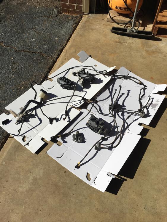

I have notes of exact weights but will give it my best recollection for this. -9.5lb for front and rear delink
Removed
Replaced

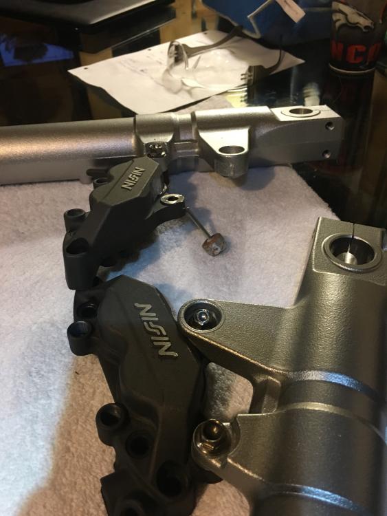

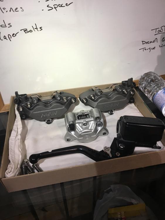

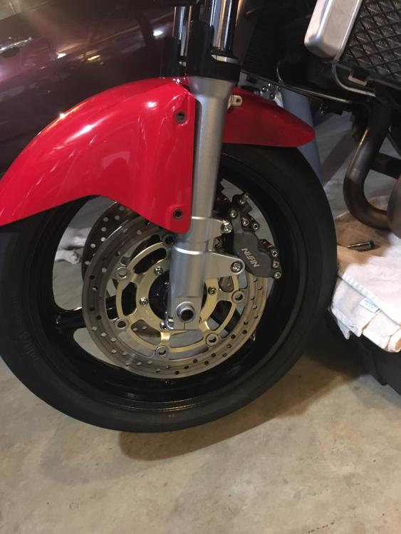

CBRF4I front wheel, front calipers, master, new VTR lowers. Lowers need a bit of grinding and TI washers to center calipers

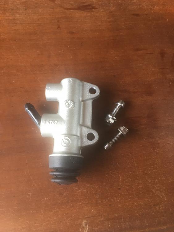

Kit from Extremecreations they did "Keef's 1098 conversion, shim and spacer worked the same for 848 eccentric
IMG_4772.thumb.jpg.ec7a688e232d1f67dccb9236cd51b4e0.jpgIMG_4810.thumb.jpg.09c18ea53c7a49a5b1bd7a0c56d321c1.jpg

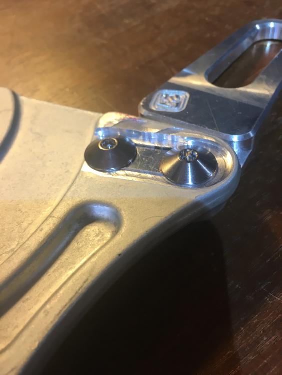

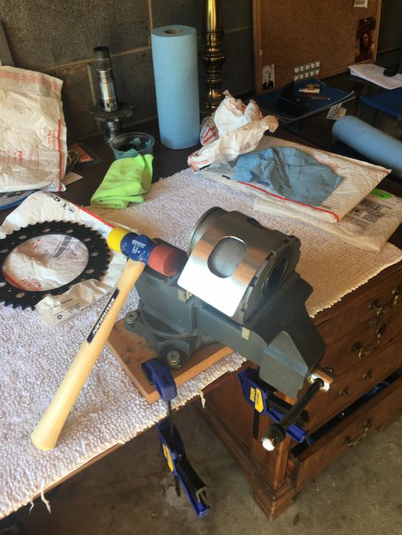

The 848 brake hanger is open vs 1098, so milled flat for clearance and used TI domed bolts to secure. The brembo master i had to open up the VFR holes a bit and use smaller 5m TI bolt and nut to secure. Used a pressure switch which cleaned up the right peg.
IMG_5006.thumb.jpg.8fbf92a83279b670c8405d61cea04a20.jpgIMG_4970.thumb.jpg.df2dfe955e00223438821347fd2f7efb.jpg

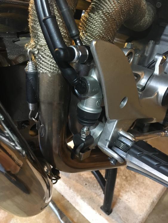

Routed the 33mm long brake line through the Swing arm, enlarged the rear hole in swingarm
The first wheel and swingarm I bought off ebay were bent which was a nightmare to return a get credit for, found a new wheel for $600. ended up sourcing all of the parts needed separately

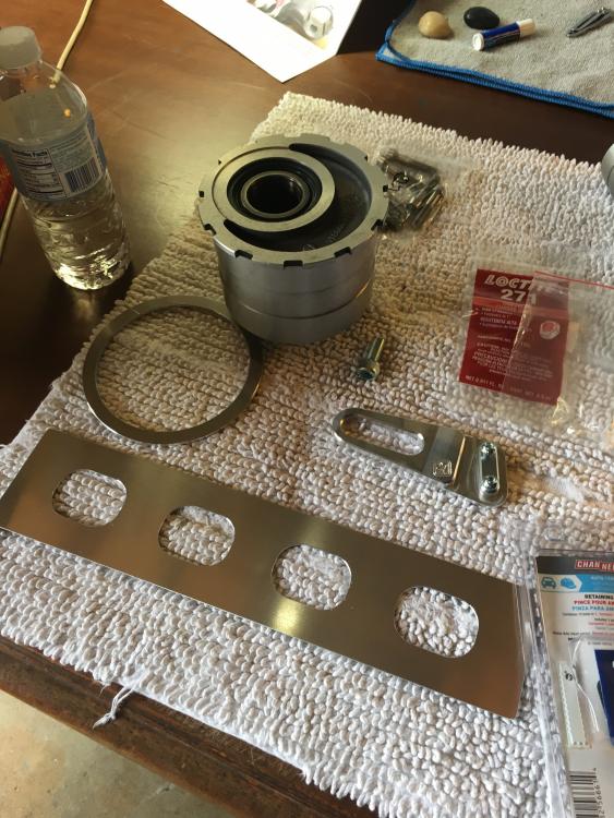

Sprocket on a 848 is a 525, so a 520 conversion is required, got 520 vfr front, 848 rear from sprocket center, chain was almost new
IMG_4951.thumb.JPG.0bfd7b39ebfae0b954e2405522d5cf88.JPG[image: IMG_5019.thumb.JPG.6758f9a1073514cbb1a5a664fb0b1165.JPG]
Front brake line length if needed is 28 and 31 inch, i know because i had to reorder, i got the bend on the top and bottom the same, 20 degrees i think, comes with 90" bend for a CBR, ask me how i know that
I think thats it. i checked offsets from a set point on swingarm was between .58mm straight wheel to 1.78mm measured with bent wheel unknowingly. Within spec of 2mm variance.
Total cost was $500 for delink $1,500 for 848 mod.
Weight savings from stock;
Wheel -3.2lbs The marchesini wheel. FYI Brembo/enki make the same wheel the bent one i got, it was heavier by more then 1lbs
Sprocket w/carirer etc.. 5 lbs
Rear Rotor 2lbs
Delink front and rear 9.5lbs
I had light weight rotor and sprocket already, so saved  -16.5 lbs, added to my already 42 lbs = 58.5 - 458 stock dry = 399.5 lbs
Yes i can feel a difference, all unsprung and rotation weight loss. If i think of anything else i will post.
Thanks again for all the help from the forum, as always !!

sorry for the repeditive pics, i tryed to switch pics it adds them but wont let me delete

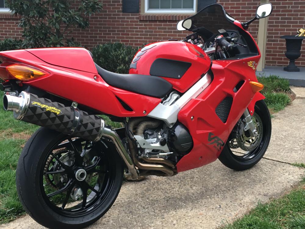

Thank you all very much, I could not wait to show it to you guys. I had wanted to do a 17 5.5 conversion for years, but any that had been done were large axle 6.0 wheels. Tight twisties is what i ride for, so realy wanted to do a 17 5.5 conversion, but didn't know if i would be able to do it, or get the wife's blessing to spend the $ necessary to try. I researched and found that a couple of 848 riders had done a 1098 conversion so knew it was possible, but could not get a confirmation on the offset. So, Happy, and Relieved, it worked out.
The Hugger is Harris performance hugger that i cut up pretty well to open up the look, but even with that and not being connected on the outside of the swingarm, it is very stable.

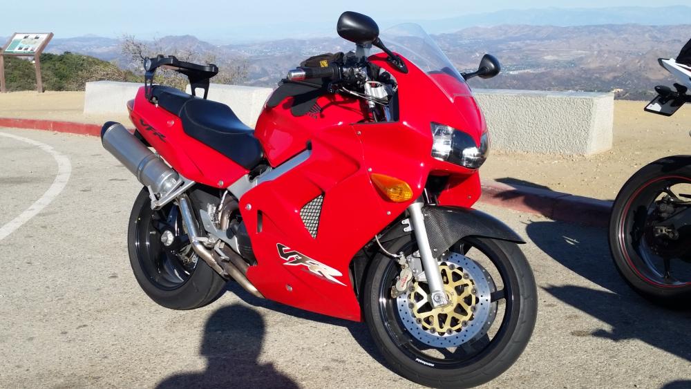

Very very nice. I have a very similarly modded VFR. I was thinking where is the big bore kit then realized the 848 designates the rear hub mod.
Love this bike.

Did you get a number for the weight saved by the F4i front wheel?
Does the F4i front wheel drop right in, or need spacers/adapters?

Hey Capt Bob, you have a nice bike as well.
What Brembos are they and where did you get an adapter.
Even better, can you post a close up of your front brake set up both sides

I wasnt expecting to mill the rear brake hanger like you did - that was a surprise. What exactly did you have to do? I can’t quite make it out in the pictures (my parts are in a shed 45 minutes away right now). Not sure I have that part you show in the first picture, just under the Loctite and bolt. The bit you bolted to the caliper carrier (I think?) with dome bolts.

You will not have to mill the hanger if you get "TI dome head bolts" as i ended up getting from pro bolt.

I ordered the, front sprocket, quick change 848 sprocket, carrier and cushes from Sprocket Center. I used a stock 848 cover. I run 17/45 or 16/43 gearing, its the best gearing ratio for me.
