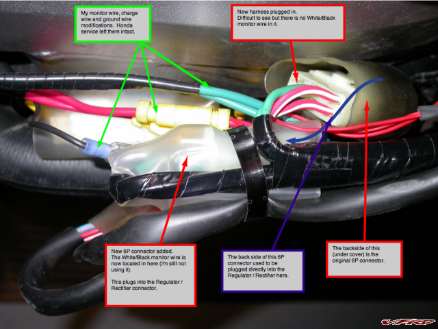

I had a quick look at the new harness kit before it was installed... it comes in two bags. One bag had the new "Starter Battery Cable" assembly - the new red/white charge wire going into the 30 AMP fuse appears larger - a good thing - and that is all thats new with it.
Next I took a look at the "Front Sub Harness" (sorry I should have taken picture). Where the stock one only has one 6P Natural connector that plugs into the Regulator/Rectifier (RR), the new harness has two 6P connectors ("natural" is the color of the plastic BTW). If your familiar with Tightwad's excellent harness "VFRness" you will understand how this works.
BTW I don't think this obsoletes Tightwad's harness since I still feel the single factory charge wire running the long way back to the battery is insufficient AND this recall only address the 2002 VFR's onwards. However, I do think you will have issues plugging in Tighwads mod and this recall harness if only for all the other plugs now on the right hand side - it is very crowded over there.
Things I wish I did:
  1. brought my tube of dielectric grease and greased all the connectors myself right there in the service department'
  2. took a photo of the new recall harness for VFRD (if anyone gets a chance lets get a photo),
  3. asked for my old harness back so that I could dissect it, and
  4. stuck around a watched install and took some pictures - out of curiosity and because I have never had the front cowl off.
When I picked up my bike I checked that all fasteners were re-installed and that all lights operated correctly. Then I brought it home and took the right panel off to see what it looks like. Here are the before and after pictures.
NOTE: I had modified my harness this summer before bringing it into Honda... see here. The service guys left everything I did alone - none of it interfered with what they were adding anyway.
BEFORE. Note the original, single, 6P connector in the top right of the photo.
Safety Recall - AFTER.
I have left my extra wiring on the bike. I like the redundancy of the extra charge and ground wires. I have also left the RR White/Black wire running directly back to the Battery. I have not put the volt meter on the new recall harness to check the recall white/black wire but I suspect Honda has now bypassed the ignition. Correct me if I'm wrong.
For those that don't work on their bikes this is an essential recall item - although the urgency of your recall letter is probably a little overdone - we have had this problem for years HONDA!! For those that do work on their bikes the recall simply address the issues we have all been fixing ourselves.
So in summary it looks like Honda addressed three issues with this recall:
  1. they upgraded the red/white charge wire at the 30 amp fuse,
  2. they had done "something" to the blue connector to address the grounding issue (I didn't look at yet), and
  3. they have addressed the white/black RR sensing wire issue.
I think Honda is reading VFRD. Now if I can only get my money back for the new RR, stator, battery, and battery harness that I replaced myself this past summer. :blink:

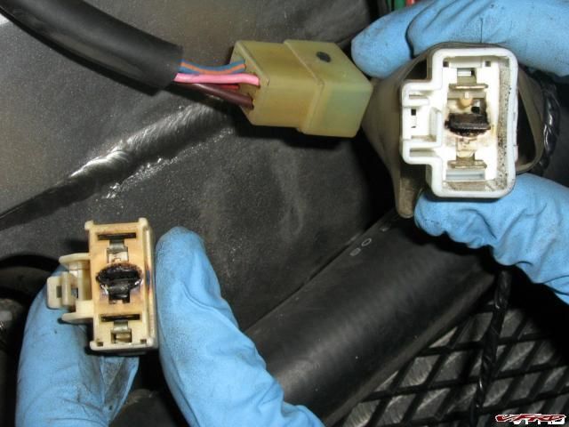

Took mine in last Wed. for the recall. Running just fine as usual. Picked the bike up later that afternoon......bike ran like crap.
Frustrated <_< but had to leave bike at the dealership. Two days later the service manager called and explained that they found a burned connector that's part of the main wire harness(not part of the two being replaced under the recall) and that he had contacted Honda's techline and sent pics etc. to them.
At this point, I'm told that a new main wire harness should be sent out for my bike hopefully this week.

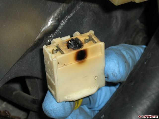

Here's the burned connector...left side just forward of the the battery compartment
[image: gallery_326_40_103523.jpg]
Burned connector after recall

Das BoneTook mine in last Wed. for the recall. Running just fine as usual. Picked the bike up later that afternoon......bike ran like crap.
That is one of the ground blocks. Others have had the same problem with them.

apparently, there are two harness we're talking about on this recall. the first harness is the front sub-harness, which runs your gauges, headlights, etc. the replacement of THAT harness is automatic, no questions asked. BUT, if the connection where this harness meets the main harness is fried, you need a new main harness, too. THAT'S where the inspection comes into play. apparently, mine WAS melted, which meant BOTH harnesses needed replaced.
now, as pissed as i was, this at least made sense with what Alba had tried to tell me all along. FBC told me that they wouldn't even be able to contact Honda to ORDER the harness until a week later (this was over the holiday shutdown), so i took the bike back from them since it's now my commuter (another long story).
two days after i pick up the bike from FBC, Alba calls me back and says they have the harness i asked for. i was completely dumbfounded that they had actually done what i had asked, so i had to triple-check with them that they indeed had BOTH harnesses for me. yep, they did. dropped the bike off on a Thursday night and picked it up one week later. but when i went to pick it up, one of the headlights was out. they told me the bulb was burnt out when they got it, which of course was BS. still, it was late and dark and i just wanted the bike back, so i took it home. once i got it under the light, though, i realized what they had done. they had removed the RH (from the rider's perspective) bulb and NOT even put it back in!!! i called them up, and of course they were 5 minutes from closing and wanted nothing to do with me. so i called them back the next day and told them they were full of shit for trying to pin the headlight thing on me since i knew for damn sure the bulb was at least there when i dropped it off. it took a lot of back and forth, but we eventually realized that what had happened.
when i brought the bike in, apparently the harness had fused itself to the headlight bulb. i don't know if corrosion had rusted the leads or if the plastic had melted and fused to the harness, but they basically had to cut it out of the bike. either the tech forgot or the service rep never informed me (little of both, i guess), and the ended up just giving it back as is. in the end, i just picked up a new 9003 from Wally World and slapped it in myself. other than that fiasco, the bike seems to be just fine. in fact, everything on the gauge cluster seems a little brighter, so i guess it helped in the long run.

Question for anyone who has done the RR monitor wire fix and has the front harness replaced under the recall----Someone may have already answered this already, but will the the "monitor wire fix" still work after the recall wire harness is installed?

vtecalQuestion for anyone who has done the RR monitor wire fix and has the front harness replaced under the recall----Someone may have already answered this already, but will the the "monitor wire fix" still work after the recall wire harness is installed?
My monitor wire is still in place since the harness was replaced, the dealer had disconnected it from the battery but when I got home I reconnected everything and it works great. As posted above I went thru all the wiring post dealer to clean it up and run things right.

So I just got my bike back from getting the recall work done and I noticed that my monitor wire fix was still intact.
Sooo...
Now that the recall work is done do I still need the monitor wire fix? Was this part of the harness fixed as part of the recall?
And whether I need it or not, will it hurt anything to just leave the fix in place?

SeanOBoyleSo I just got my bike back from getting the recall work done and I noticed that my monitor wire fix was still intact.
Sooo...
Sean
The recall monitor wire now connects to the + wires just down stream of the rectifier plug. This is an improvement over the old routing through the ignition and fuse block. I would think it should connect closer to the battery like your fix.
6 months after I had my recall done on my '02 the new recall 30 amp fuse by the battery started to heat up and voltage at the battery dropped from 14v to 13.5v
I did the monitor wire fix and replaced the 30 amp fuse holder with an in line ATO fuse holder w/ 12 ga. wire from the auto parts store. Now no heat and the voltage is 14.3v
So I would keep the monitor wire fix.
