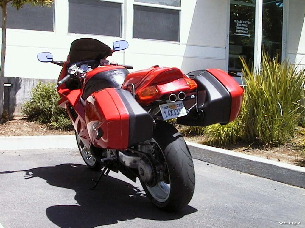

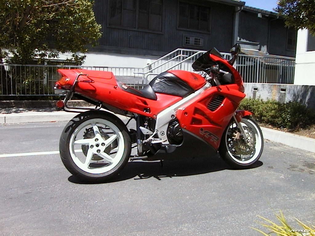

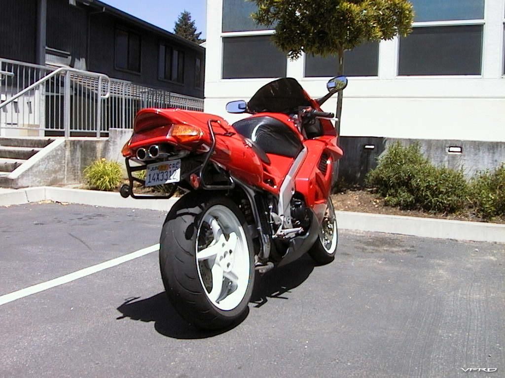

Well folks I finally got the exhaust done on my 94. As usual it took much more work than I expected but the results are better than I had hoped for. I used a CBR1000 muffler or at least the back half of it. The chrome tips are cheap parts from a VW shop. I just used a U bend that you can get from any exhaust supplier and some scrap metal to patch everything back together. The big issue was clearance for the tire, which required mounting the muffler quite high in the rear sub-frame. I wanted the exhaust pipe to look factory and fit snug so I had to remote mount the rear brake master cylinder and modify the heat shield. I ended up removing the entire inner fender and making a new battery box then adding sides the the sub-frame with sheet aluminum.
I also just got a set of hard bags and modified the brackets to work with my bike. This project was easy and done in about one day. Next comes some powder coat, a new hugger and rear brake line.
I have also started collecting parts to upgrade the suspension. I have a fox shock for the rear and last night I bought an Attack triple and GSXR fork set. The forks are off a 1991 GSXR 1100 and I plan to sell them to help fund a set of R1 forks/brakes. The attack triple was built specifically for the 86 VFR, anyone know if there are any significant differences in the specs from 86 to 94 that would prevent me from using these as is?

Man, that was a lot of work but it looks great.
It looks great, the dual tips look just like the Wolf system, nice job. And adapting the 6g bags is very cool. :fing02: Makes me wonder how hard it would be for the 5th gen bike.

can ya post up a few more pics of the hardbags/mounts? That sounds like it's got some possibilities.. :fing02:
I will take some more detailed pics of everything this weekend.

Pics would be great. Did you do the welding yourself? I'd be very curious to hear how the underseat heat management works out with the RR muffler. Do you ever get over to the valley during the summer months?
That looks like a better/tighter fit than the old Wolf system and without all the crazy tire clearance problems that came with it!

X 32 on the pics of your 6th GEN hard bag adaptation. As far as I'm concerned it's the only thing wrong with my '97-no clean hard bag install for it. Looks like you've got the solution. BEAUTIFUL job.
Ok so where are the how toos? Id be interested in seeing more how you attached the tips. I like the look a bit better than my 600rr muffler. I have no idea how you got the 1000 muffler up there as the one I have is too wide for the subframe. Post up some pics of the up pipe and all. If you find it needs more clearence I have some tail risers I had made up. Brian

Bike looks fantastic. I'm powdercoating my rims white first chance I get too. When I put F2 forks on my 86 vfr I had to swap the steering stems as the CBR S/S was quite a bit shorter than the VFRs. Sounds interesting keep us posted.

That is just super sharp! Nice job integrating the gen6 bags on the gen4 tail!

The bike looks fantastic with your underseat pipe setup and please do show how you fitted the pannier setup :+1:
