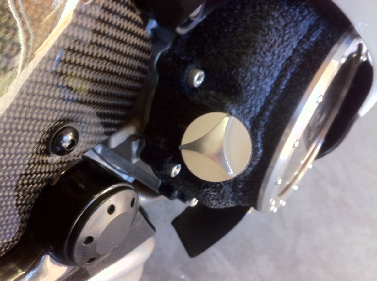

And as I was screwing the cheesy plastic oil filler cap on, I was wishing for a nice billet aluminum one. The last one I bought from EBAY claiming to fit "most hondas" actually doesn't fit a VFR. It was too small, so I sold it again.
SO, I did some digging and found that it's an M24x3 thread, and a BMW F650 uses the same thread for it's filler cap, so I took a chance and ordered one.
There are some on EBAY for the RC45, but they are a hex head, and I wanted a "normal" top, like the stocker. So here is is:
Got it from Pro-Bolt in the UK, as interestingly enough, the USA site clearly states that they do NOT ship outside the USA.
http://www.pro-bolt.com/
P/N LOFCB10S and I'll update once it gets in to see if it fits.  ₤17.49 including shipping, ex VAT.
Oh, and the wrinkle black paint came from a can, usually used for engine valvecovers and the like:
http://www.vhtpaint....rinkleplus.html
I was originally going to remove the oil sight window and have the cover powdercoated, but Seb had applied a special aircraft sealant to the backside of the cover, just to be 110% sure the weld would not leak, which it probably wouldn't, but anyhow.......better safe than, well you know.
The upshot was that the sealant can't take the 400'F necessary for powdercoat, so I masked and prepped the cover for the paint, and proceeded as per the destructions on the can.

As I was screwing the cheesy plastic oil filler cap on, I was wishing for a nice billet aluminum one. The last one I bought from EBAY claiming to fit "most hondas" actually doesn't fit a VFR. It was too small, so I sold it again.
Got the part today! All the way from the UK, that was fast!!!
Comes with an O-ring, so you don't have to re-use your old one. It wasn't identical to the pic in the ebay auction, but that's fine. I really didn't want it drilled for safety wire anyhow.
So for the 5th gen, 6th gen, and RC45, a BMW F650 oil filler cap WILL work. Part number quoted above is legit!

Soooo, just to clarify, the one you have pictured here installed on your new spiffy clutch cover is one you ordered from Pro Bolt?? It looks sick, I like it!!!
Metallican525
Yes, Pro-Bolt P/N LOFCB10S which is for a BMW F650. It comes in several other colours also.
The "S" suffix is the colour, in my case, silver.
Part No: LOFCB10
Description: Aluminium Oil Filler Cap BMW F650/Etc
Thread Diameter: 24mm
Thread Pitch: 3.00mm
Weight Gms: 35.20
Price: $16.50
http://www.probolt-usa.com/Products/000300140015

The window is made of lexan. No leaks in about 2500km of riding thus far.
As for 4th gen availability? Well you'd have to PM Seb and see what he says I guess.
I designed the rings especially for the 4th gen cover. By chance, they fit a variety of other covers as well.
I would love the opportunity to make a cover for you Badboy, shoot me a PM if you'd like to discuss some details.

had a visit from Mr. Postman. (protective paper still on Lexan)  Now......how do I ugly this thing up?????
I would love to do it up in that fake magnesium bronze finish that is on the case covers of the 2nd gens, but I doubt I could fins that colour anyway.  I thinl I'll just blast off the paint and clearcoat the ally.

So I stopped by fastenall for stainless harware & found out they only sell it in bulk... Anyway, if any of you are interested in M6 x 1 x 25/30 stainless hex head cap screws for the cover and for the clutch pressureplate bolts let me know...
Hey V8C and Timmy- what is the best way to prep the cover for paint with the oil window still in it? I'm worried about the effect solvents may have on the clear window and window seal.
For paint or powder, the best thing you can do is tape off the sight glass and the seal surfaces, and glass bead or sandblast the surface to be painted. Then thoroughly clean the part and prime/paint.
All I did was clean the cover with varsol (think about it, the oil window is bathed in oil all day, and it's fine with that, and varsol isn't far from oil).
After that, hot soapy water and rInse/let dry. Then paint.
