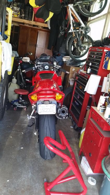

I sold my RC51 and bought an amazingly modified 99 VFR. I am hoping to learn about the build and need help identifying the builder. The seller was not the builder but a friend of his in Laguna Hills CA
More pictures to follow. I plan on keeping the bike as it has 18k miles and every mod I could ever want to do. Here are the list of mods which are said to have removed 70lbs from the stock weight.
Full Brembo brake system front and rear
Attack adjustable triple clamps.
Converti bars
Marchesinni wheels said to be HRC issue
HRC single nut spindle/axel
Penski rear shock
Traxion Dynamic cartridges in forks  reb adjustable
Two bros full exhaust system or at least aftermarket SS headers with hi mount SS 2 bros slipon.
Dynojet PCV
PC quick shifter.
Speedohealer and Kriss head and brake light strobe.
Clear double bubble wind screen.
Ignition key switch replaced by 2 toggle switches to start.
 The fuel tank is mounted high in the front which may indicate an airbox modification. I see temperature foil tape on the airbox. (Have not opened it up yet)
Not bragging yet as i have a lot to learn about this bike a d am hoping one of you can help me find the build thread for it. Oh and I am so STOKED to be on a VFR again.

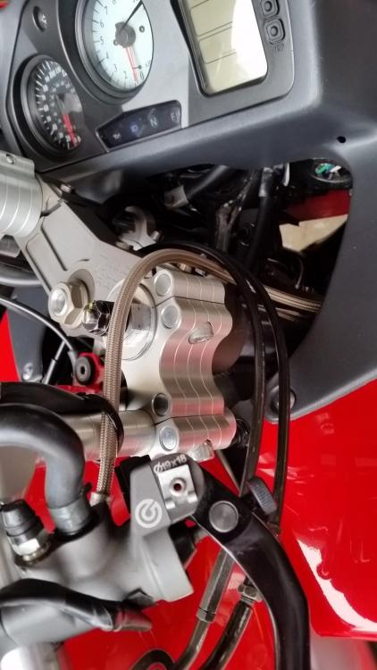

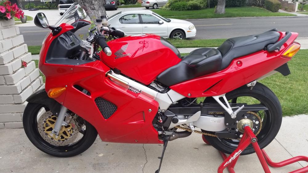

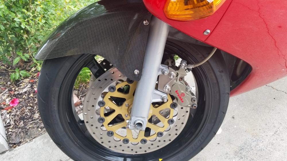

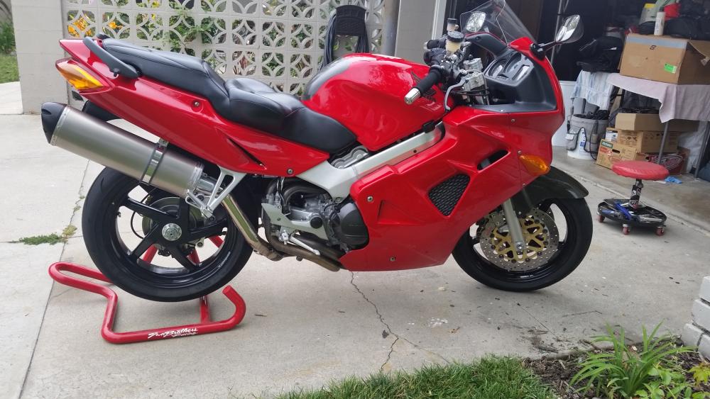

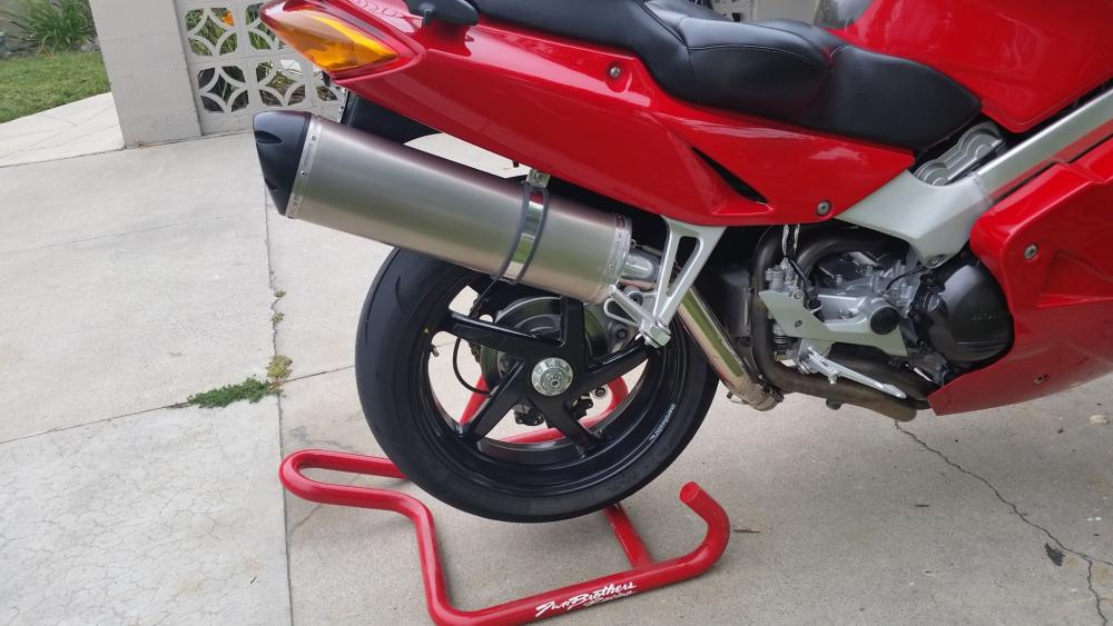

Turns out airbox is stock with heat wrap. Even has snorkel in place. Ak-20 Axxion cartridges in forks. Penski is 8987 and steering damper is not yet identified. Wverything is ultra plush right now. I need to set up suspension more to my liking.
Fancy seat. Could shorten the can a bit. Defiantly a keeper, somebody know what they wanted and built it. Hell of a find.
That's some saucy bike porn going on there!!
That seat looks good to my boney old behind. :happy:
Well well, interesting set up, I was sure it was going to have a USD front end,  didn't know Brembo had a kit like this. Yep that's a different rear caliper, as it doesn't look like the stock one. Which in this case it would need to be swap as the stock caliper wouldn't work with that sweet rear wheel.   In the one photo that shows the collector, it does look like you have a real 2bro header.  Again, Nice score.
Still would like to know how it's 70lbs lighter?  Wheels and header might shave off 15,  center stand gone and de link another 15. If it has a lithium battery, another 3-4,   Ti sub frame?  ;)   it's all good, thats a sweet find,  some folks know how to be in the right place for sure , love that rear wheel  :goofy:

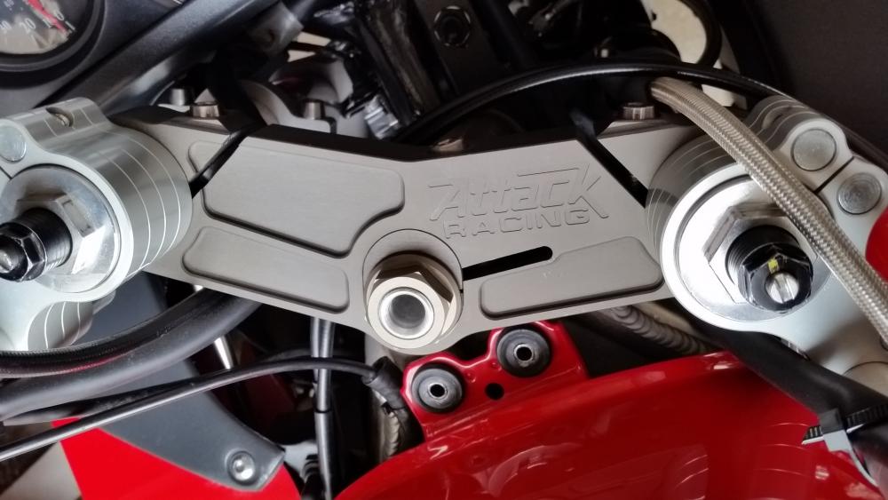

Welcome back Cap'n - it's like you were never gone [Little would I know]. Those Attack triples have more layers than a Taco Bell layered burrito. Make sure you have the triples on your research-the-build list. Attack can and does make anything their customer is willing to pay for and what the PO did or did not have them do with the triples is mighty interesting. It appears that the Traction cartridges reside in new-from-the-factory VTR lowers...luckily, it also appears that Brembo makes an adapter plate and caliper that fit the VTR lowers perfectly. Can't wait to hear about the ride feel once you get the suspension set to your liking.

Those aren't VTR lowers; if they are 43mm diameter, my guess would be CB919 (CB900 Hornet) forks.

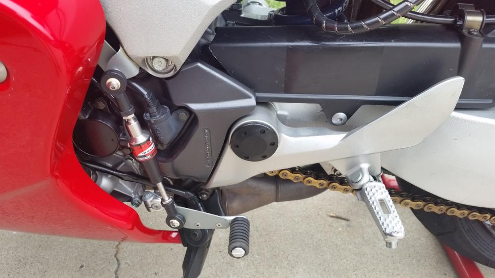

Quick shifter is plug and play with the PCV. Not sure about PC3. Fairly sure the fork tubes and lowers are stock with new internals.  I could be wrong. Custom bracket for brake calipers. Rear caliper is a twin pot Nissan like cbr f2.

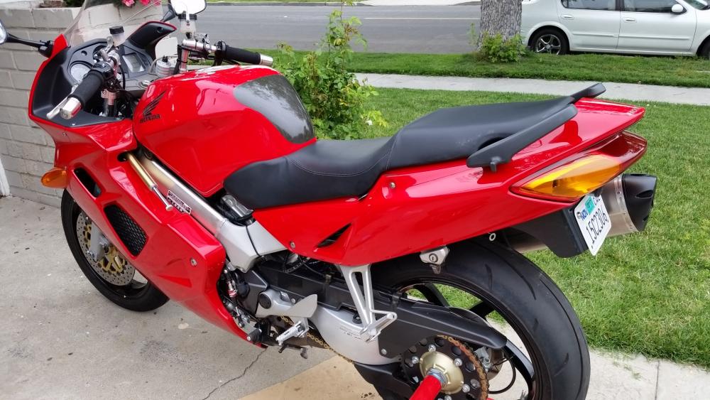

What is that seat? I've never seen one like that before?
43 minutes ago, Woodie
Russell seat. All i know is it really coddles the bum. More than seargent or corbin. Iron butt mod.
2 minutes ago, VFR Capt.Bob
Looks comfy, Cheers.

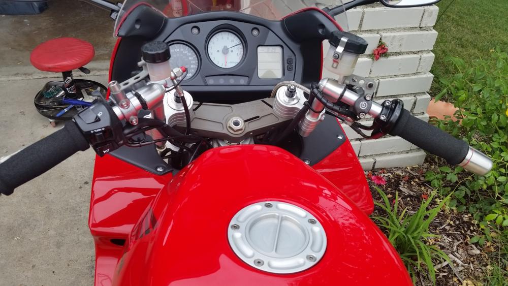

It's funny that it has modifications that suit performance/handling, but has bars that are higher and further back, and a seat that looks like an old mans lounge.
Sorry mate, but that seat looks like it belongs in an old peoples home for hemorrhoids sufferers.

Never seen Attack triple clamps on a VFR before, 5th gen or not.  But as someone said in an earlier post, back in the day if you wanted to pay, you could play.

Put the bars back to stock and let er' rip.

Price included spare parts. Stock clip ons too some will be happy to know. The Russel seat and BMS modified stock seat. Rear stand, honda bike cover and 2 shop manuals. Yes i have a spare for sale now. All together $3500. Owner was motivated. Had a garage full of modern track bikes including a supermoto and a grom. Had it listed for $3900 but said I was the right owner for it.
I will keep the Russell for real life touring but for everyday the stock modified one will be on it. Seriously considering the stock bars and a center stand. Converti bars have a tone of adjustment. Will likely play around with them some but it is a daily driver so don't mind them for now. They and the sponge grips are a little much.
I had to try that seat out. LMAO. Rode it to work that way and quickly covered it not wanting to be seen with the Goldwing seat on my Interceptor.

The forks do go great with the build. Terry, I've never run across 919 forks as 43mm upgrades - thanks for pointing that out. How can you tell they are 43mm and not 41mm?
I also realized that the features I thought were layered triple clamps are the bar risers.
