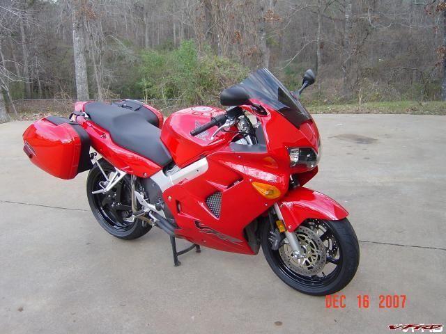

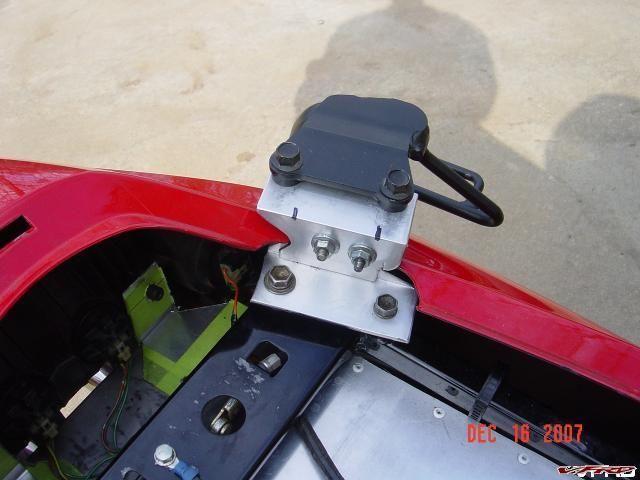

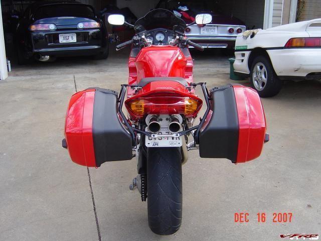

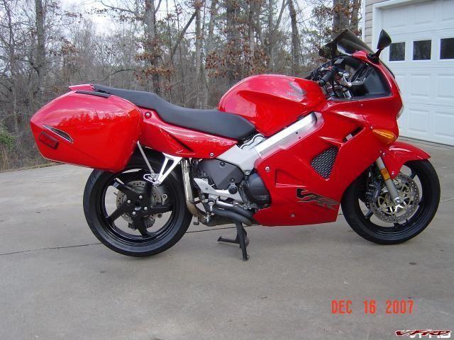

Here 'ya go!  :fing02:   The mounts looks to be stock 6th gen adapted to fit.  There are some more detail shots of that if someone wants them.  However, note the Wolfe exhaust . . . that too has been replicated so still possible for a committed owner.  It would be interesting to know if this could be done with a low mount exhaust.  I really dig this setup.

Neatly done, but our "finest" would pull you over pronto as the licence plate is obscured.
Hard to see how/if he supported that section.....
If it is just the struts at angle towards the passenger pegs and the (aluminum?) brackets at the top, I would not fully load the bags and ride WOT......
Givi has lots of options, but I do like that 6th gen set up.
5 hours ago, Dutchy
The Givi bracket also has that rear strut bar across the back.  I am dropping my plate mount to have it more visible.
The OEM setup has a solid metal bracket running from the rear subframe down to the back/inside of the licence plate holder. Here a metal plate is affixed that connects to the rear struts.
I modified that to fit the rear subframe of a 4th gen. This made it very very solid..
Despite colliding into an oncoming car that turned left infront of me, noting snapped or bent...
Full disclosure - that is not my bike.  The mounts do pick up all the mounting points on the 6th gen brackets (though the lower one from a different angle), so my intuition sez it should be solid - at least as much so as on 7th and 8th gens, but hard telling without seeing it person.  Good point on the plate - could probably be overcome by fabbing a bracket similar to the 6th gen setup to allow for exterior mounting of the plate.

That adapter bracket doesn't look like it's all that hard to fab, Hmmm....
 Would figure something else for the bracket around the license plate...
The lower mount is attached to the footrest hanger by a rod,  prob ok front to rear,  but maybe not so much laterally.  On the 6th it attaches directly to the hanger,  so is solid.  Maybe something fab'd that drops straight down from the rear sub frame would anchor it more securly as well as be more or less out of sight.

No, but it also looks like it won't last a season of riding.  I've had steel luggage brackets that cracked and had to be re-welded en route, and those look like simple alloy angle.  GiVi itself had to re-design their (steel) VFR800Fi brackets because their earlier design just couldn't take the punishment.
Let's just say that doesn't look "over-engineered" to me!
