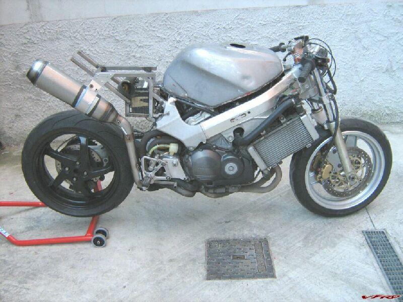

Hello.
I can tell you that many Honda stems are the same which VFR uses, perfectly the same.
On my "track use VFR" that now fits a GSX-R 1100 conventional forks i have used a stem coming from a 1987 CBR 600 (in USA called Hurricane) inserted in the Suzuki lower clamp.
The only modification required is welding a "lip" in the lower edge of the stem to lock the two parts once everything in assembled.
Like the VFR this stem are in one-block with the lower clamp too , but it's enough remove the welding joint with a lathe to have a stem that can be used on great number of lower clamp.
Here' the pictures:
This is the bottom of the 1987 CBR 600 lower clamp. Pencil shows the welding.
This is the stem after the welding removed. To extract it i've used a common workshop hydraulic press.
The CBR stem compared with a 5th gen VFR 800 lower clamp. Absolutely the same.
Note at the CBR lower edge the "lip" welded to assure the complete fixing once the stem are inserted in Suzuki lower clamp that i've used.
11th March 2009
Here the GSXR 1100 front fork installed.
Ciao, Luigi.
